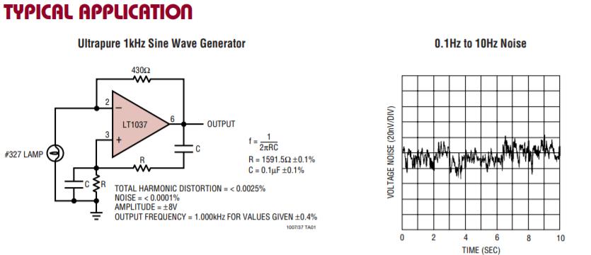

Or one of the large Crown amplifiers like the CDI400 that will put out 2KW at 140 volts and you don't need any output transformer to limit the output power. You would wire it in the bridge mono mode. All you need is a signal generator to provide 60 HZ, (50HZ if you want to test 50HZ equipment). If you can find one of the older Macro Reference or Studio Reference amps they will also swing enough voltage to run your equipment. I have run my shop vac off my Macro Reference. The harmonic distortion of the CDI4000 is .05%, better than you will get with any raw utility input voltage.
https://www.crownaudio.com/en/product_d ... b6172ca1e8
If you want to roll your own sine wave generator you can make a very low distortion sine wave generator using the LT1007 Op Amp. The schematic shown has values for 1KHz but the formula is there for any frequency. Note the distortion and noise. There are also circuits out there for crystal controlled oscillators.
