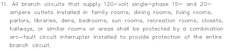

Here is the spec for "breakers" in my new house under construction. As you mentioned they are arc fault interrupters that look for high frequencies on the line caused by arcing.
Yes. That's the current code requirement and has been in effect since 2015.
