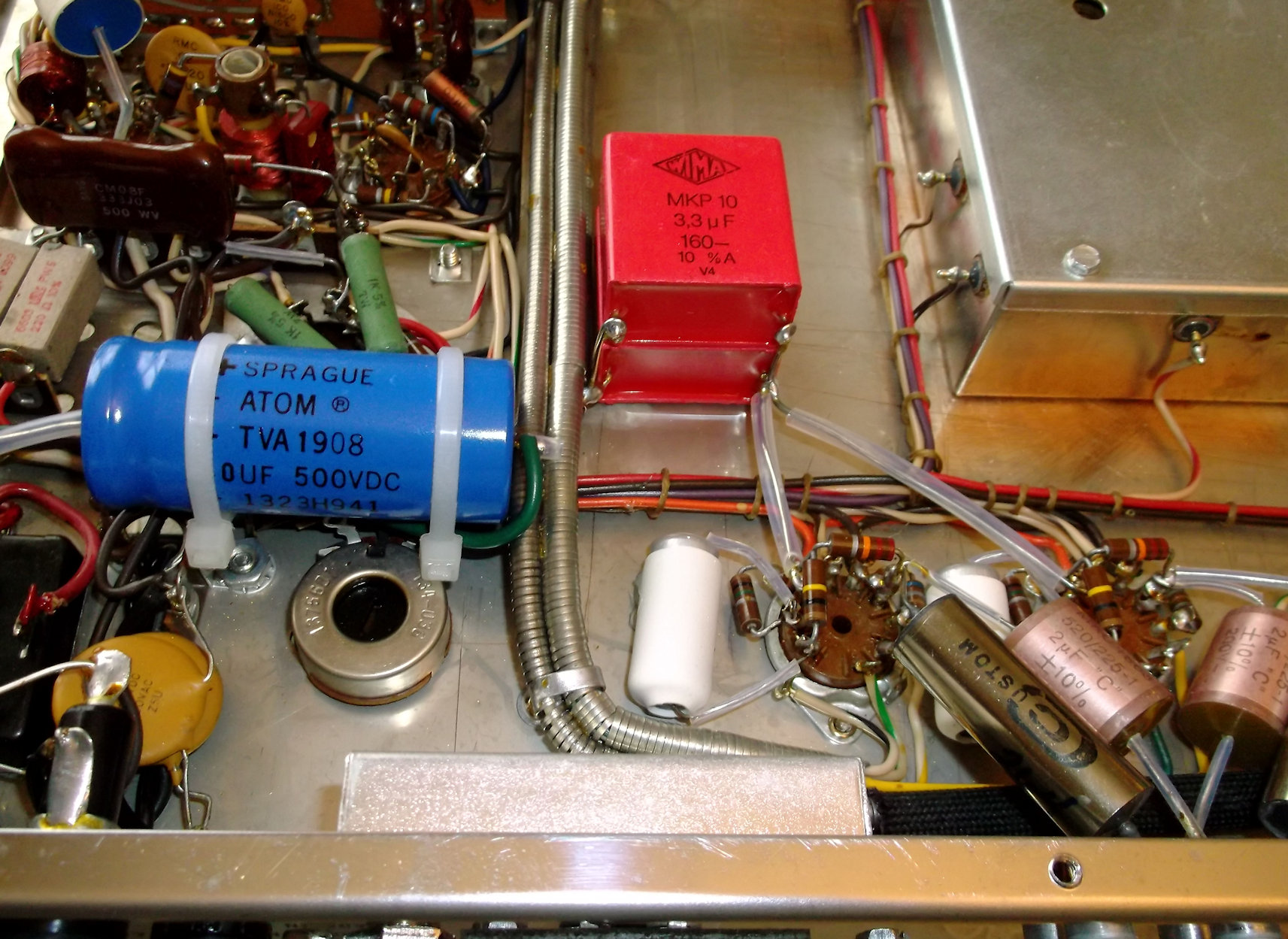

I have a MAC MR-67 that preceded the MR-71. Basically -- schematically they're the same with some upgrades. Because of age I had to rebuild the power supply, but otherwise my MR-67 was mint. I got lucky to say the least. Anyhow, if you really want to hear what your MR-71 is capable of you want to upgrade the MPX board, upgrade the audio section, add some nice film caps to the power supply.

Nice work on the MPX boards! There is a site "Dark Lantern" that walks through some modifications that appear similar to yours. Bill Thallman years ago did a modification and alignment of my MR71, putting in a regulated supply for the MPX and output section, replacing the 6BL8 output section with a 6DJ8 cathode follower with some nice quality output caps since the output level from the MPX section is sufficient. I am thinking about touching up what he did (like adding a current sink to the cathode follower), but it is so damn tight to get to the cathode resistor (I would have to desolder almost everything on the socket just to get to the resistors). He did some mods to the MPX board, but I did not look closely at them. For now, I better leave it alone, since not clear what he may have done to make the MPX section double as part of the output.

Hey David! Thanks for the complement! The MPX mods consisted of exactly matched resistors and capacitors. What was original was carbon-comp resistors and cermic caps. I replaced these with matched Roderstein metal-film resistors and stacked-film polycarbonate caps among other upgrades to the MPX section that you may have observed in my photos. There were many other changes but that was most influential on the sound quality.

I need to take a closer look at the MPX board on my MR71, since not sure if Bill Thallman went to the level of detail you did. I noticed a few places where he replaced capacitors, but did not immediately notice any resistor changes. How extensive of a rework did you perform, i.e. just the MPX oscillator, or the entire board.
By exactly matched, did you mean to the (a) original in-place components, (b) the values on the schematic/parts list and between left/right channels (i.e., after the 38kHz oscillator). Carbon comps will drift, of course, so (a) is unlikely. For (b), the values seem to be for 10% (some 5%) tolerance components, so using 1% resistors and 5% (or better) capacitors would be a lot better than what is there. Did you need to readjust the MPX section after you worked it? I have the service manual (of course), but lack some of the test equipment (I.e., RF signal generators) necessary.
Was there a technical reason for using polycarbonate vs styrene or PP capacitors. Is that what you had on hand?
