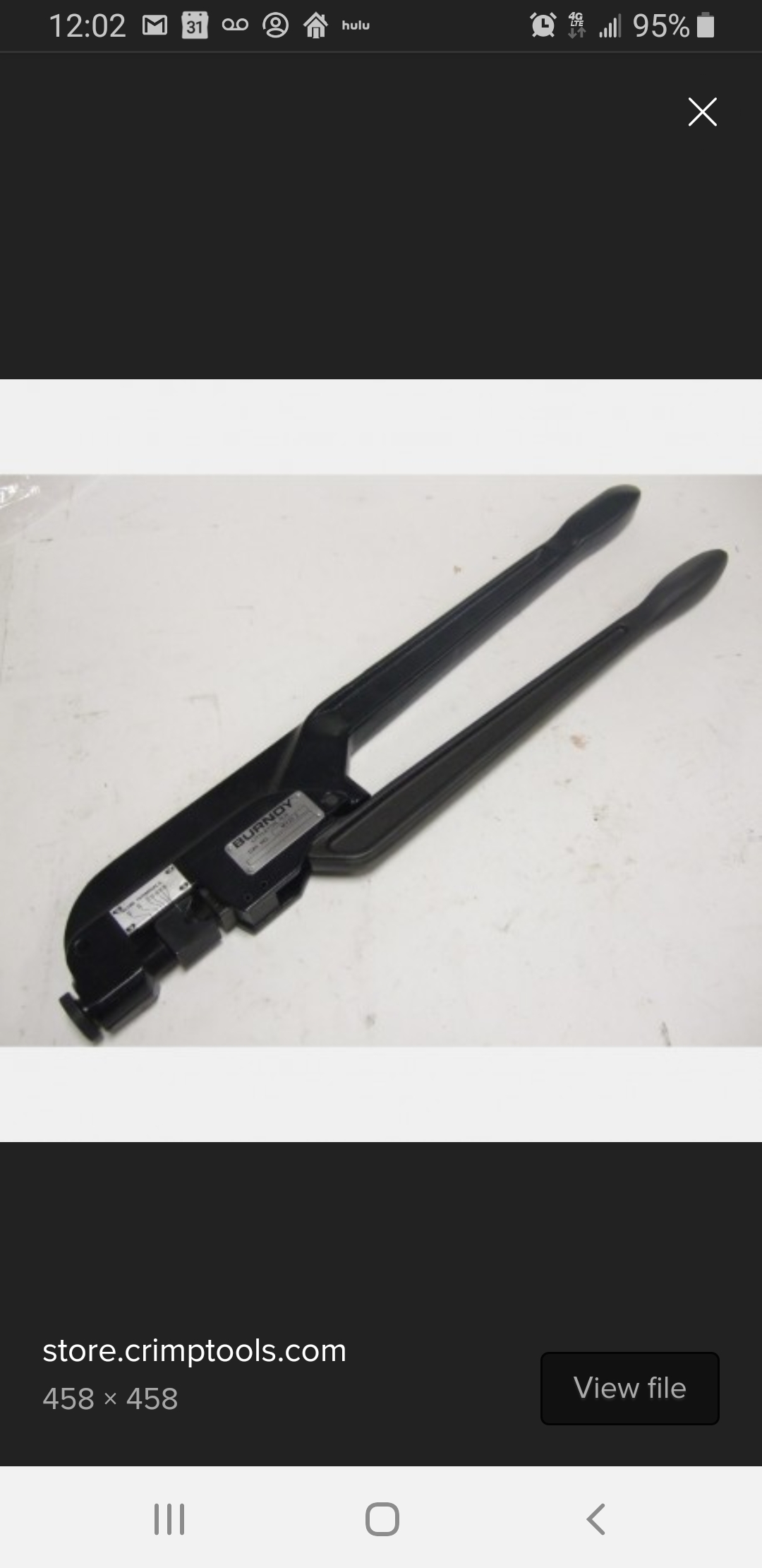

Electrical supply house.
I use large cables as well, #14, 12 & #8 in parallel sets. I use s #6 crimp lug with a tight slot cut to fit the binding post. As has been pointed out, very high pressure crimp is the best connection.
Rent a crimping tool or get an electrical supply house/contractor to do it for you.
PostPosted: November 5th, 2019, 1:04 pm
Crimp tool
