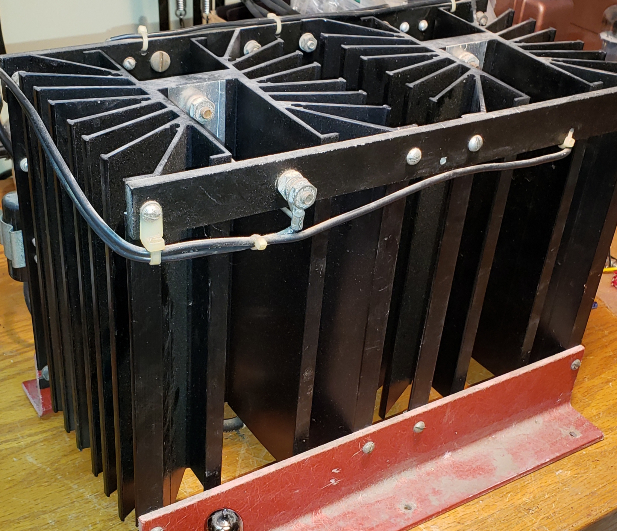

David, do you think these heat sinks are big enough for 25 watts?

What is the size, I don't have a very good sense of scale based on the picture. Also, the form factor doesn't look like it will work well for the stock boards. Looks better suited to TO-3 devices. There are 6 TO-247 devices per channel, so really tough to get them all on a heatsink like that. That looks like it could take 3 TO-3 devices. Not to say you couldn't fabricate an aluminum channel bracket to extend a mounting surface out, but the MOSFET board is about 10 inches long. My gut feel is that thermally, those together are probably good for one channel at 25W Class A.

That's the top of an ECC99 power left of the picture. They are around 9" tall, 6.3"square. Click on the pictures to see correct orientation.

PostPosted: August 29th, 2019, 10:03 pm
Find the rating of the sink as specified in degrees C/watt and add about .25 degrees/watt for the case to sink interface and then add the junction to case factor of the transistor. Then multiply by 25 and you will get the temperature rise on the junction. The transistor spec will then tell you if that is adequate to keep the junction within working range. I would suggest that you stay about 20 degrees C below the maximum junction temperature for reliability. Note that the most efficient cooling is with the fins vertical and at least 1" space between the bottom of the fins and the chassis.
That sink looks similar to the Delta 441 sink I used on the Cherry Bomb that has a thermal impedance of .6 C/W. Lets just guess that that is the impedance of your sink and add .25 plus .75 C/W for the case to sink and junction to case interfaces. That gives 1.6 C/W. Multiply times 25 and you get a 40 C rise in the junction above ambient. Assuming your ambient will not go above 130 F or 54 C the junction should be around 94 C max. Normal operating max temp of a silicon junction is 125 C but that can vary. Check the spec sheet. If the max is 125 the 94 is the expected max it would still give a reasonable safety margin. BTW, the sink even at lower ambient temperatures will be uncomfortable to the touch.
PostPosted: August 29th, 2019, 10:39 pm
Stuart,
The heatsinks are a bit larger than I thought. The BACO boards are 10" long, but the distance between the outside edges of the two outer MOSFETS is 8-1/2". So the heatsinks are just barely long enough for the devices. What I recommend is get a couple of feet of some 1/4" thick aluminum angle, maybe 2" x 3", but the long leg being enough to clear the heatsink. Then rip cut/machine the shorter leg of the L so that it fits inside to the center web of the heatsink. Using the existing holes, drill and bolt the angle to heatsink, using thermal compound. It will probably help to smooth and flatten the surface in contact with the heatsink (via sanding through grades against a flat surface like a table saw bed or surface plate. Of course, drill out the holes for the MOSFETs prior to mounting. Once you have the output stage up and running, and starting with a low bias, increase the bias over time until the MOSFETs are around 50 to 55C. Use a temperature probe on your multimeter (if you have this feature). Once that is set, you are safe. I think it will likely work just fine, though it will be ugly. Just put a cage around it.

David, thanks for the angle aluminum idea. I hadn't come up with a more elegant solution.
Tom, thanks. I do know how to do heat sink calculations. I don't know the rating of the sinks I have. They are twice as tall as the Wakefield sinks you are using and an inch or so larger in each of the other dimensions. It might be reasonable to assume 0.3°C/W. Just not sure.
Probably okay for 50 watts each, or less with longer mosfet life.

Stuart,
You seem to be set with the heatsinks you have, a little bit of creative energy and you should be able to get something working. However, I ran across a source for large flat heatsinks similar to what I have on my amp chassis:
