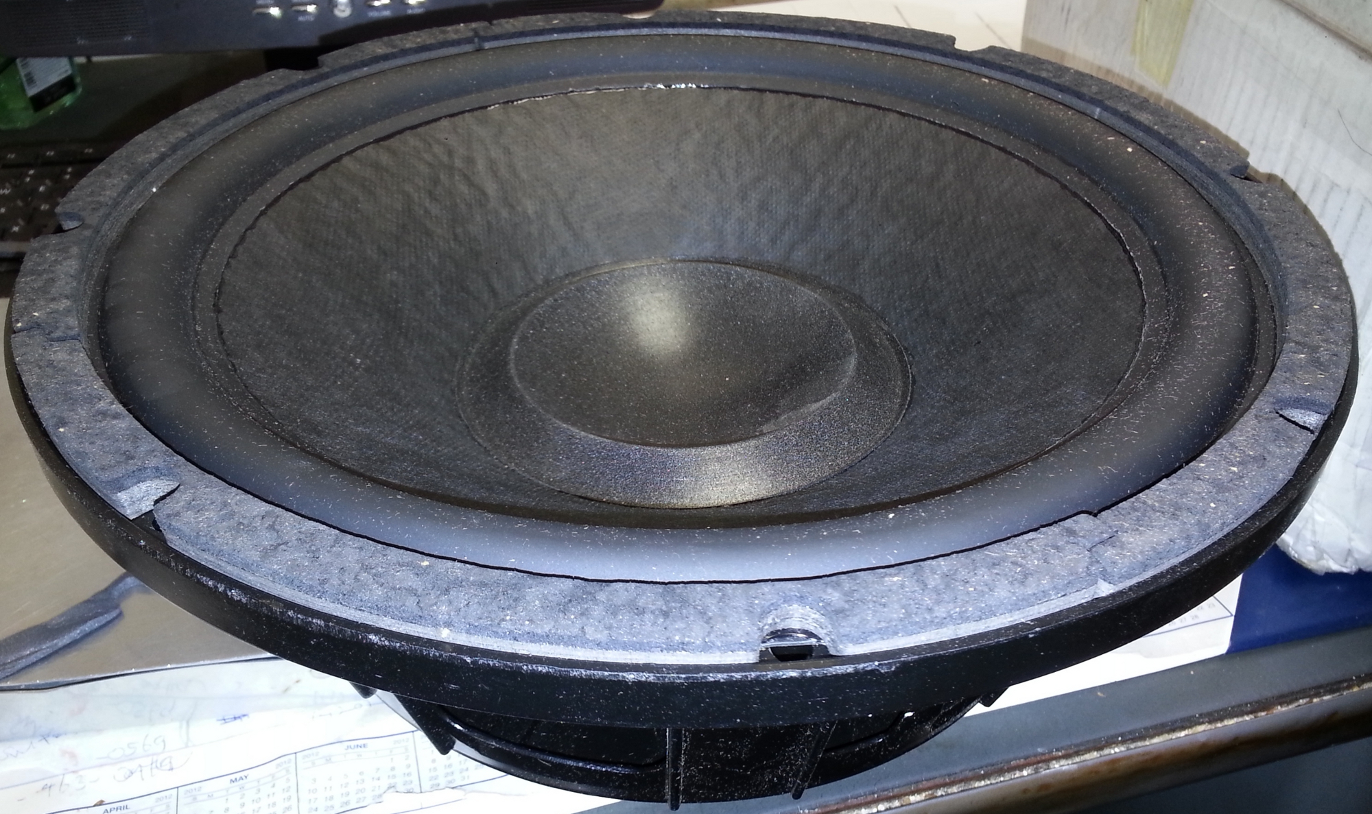

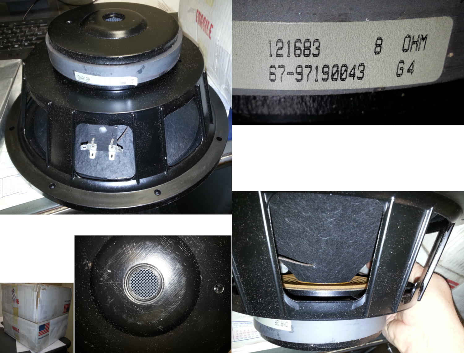

Are you looking for freebies, or are you paying?
If you are paying, I have a pair of new, in the original box, custom Eminence 12" woofers.
Here are the T-S parameters, if they work for you.
They sound excellent in the right enclosures.
$100 each.
RE OHMS 6.31
FS HZ 26.59
LE MH 1.49
MS GMS 71.80
QM 9.70
CMS mm/N .4990
QE .440
RMS NS/M 1.2367
QT .420
VAS LTRS 189.11
XMAX MM 4.80
SD SCM 519.45
BL TM 13.13
EBP 60.5
EFF % .78
SPL dB 90.9
