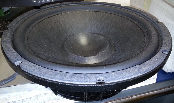

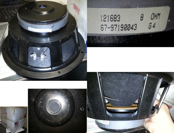

PostPosted: December 12th, 2019, 9:29 am
Are you looking for freebies, or are you paying?
If you are paying, I have a pair of new, in the original box, custom Eminence 12" woofers.
Here are the T-S parameters, if they work for you.
They sound excellent in the right enclosures.
$100 each.
