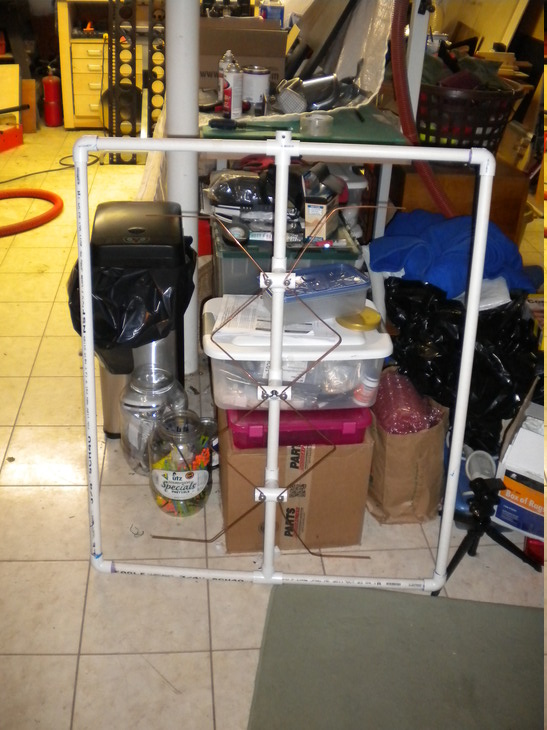

The nice thing about this is the ability to rotate the elements and get max signal, min multipath.
I stripped out the amplifier guts, and it's just a passive unit now. Fine for urban/suburban zones.
Basic antenna is 300 ohm. Adding a 75 ohm balun reduces signal level and quality by just a bit.

I also have an DIY digital TV antenna. It needs a ground plane attached to the pvc frame. Output is 75 Ohm coax.
