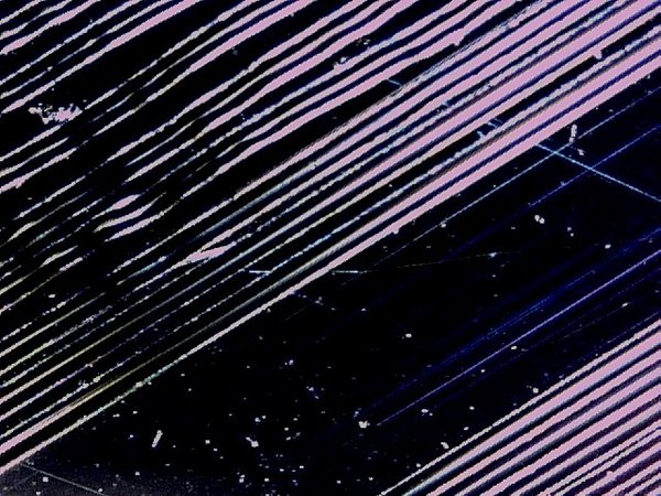

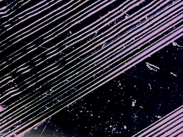

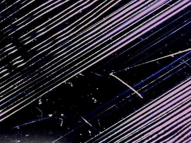

Funny thing you would mentioned record cleaning. A year ago I built an Ultrasonic cleaner and was sold on the idea that I could clean 9 lp's at a time.
Well I have since gone back to the SpinCleaner. This is an $70 product that bested my Nitty Gritty and Ultrasonic cleaners easily
I use my own mix which is the standard 3 parts distilled, 1 part 90% isopropyl and a few drops of Kodak Photoflo
I have tried many commercial products and saw/heard any differences. What matters is if the record is very dirty do multiple cleanings.
I clean new records at least twice and used records a few to many times.

Neat. What are these photos, exactly? Presuming some sort of photo of a record?

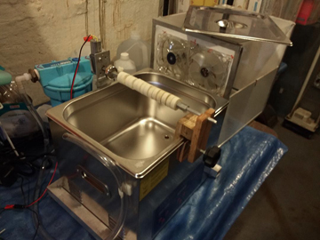

This is my ultrasonic, a 10 liter tank, ebay cost with shipping was $150. Motor frame was built out of stock aluminum channel from HD
Filter was a whole house 5um filter and an aquarium pump, probably going on ebay soon
It worked ok but I got a better clean with the Spinclean.
The pics a 200 magnification of an dollar yard sale LP. Starting from the bottom each pic is an additional cleaning and you can see they are getting cleaner as you go up

I have been dreaming of that commercial $4K ultrasonic solution but just can't get myself to pull the trigger. Interesting to hear that you have had better results with the Spincleaner vs US.
ill, this one looks interesting since it is pretty cheap and would be a welcome change from my hand wash in the sink method! :lol:
https://www.ebay.com/itm/Vinyl-ultrason ... Sw95lXE6kW
I wonder about just running it at 120V which should slow it down, provide better cleaning (assuming the coils can handle the increased current)?
PostPosted: December 13th, 2017, 4:17 pm
Its the same tank but in a nice case
I had a long talk with Greg Viggano whom I met at CAF. He is working with American U in their Vinyl archive developing a cleaning solution and methods for their library.
He told me the problem with all the LP ultrasonic cleaners out there, is that the LP's are moving through the solution and this disrupts the micro-bubbles. If you think about it, when hospitals, jewelry, watch makers clean their stuff it is not moving through the solution, so the cleaning action can work unimpeded.
That $4k machine works because it has rollers scrubbing the surface of the record. That's what cleans the records not the US.
Greg gave me a sample of their cleaning solution, and I found it not any better than my soup.
