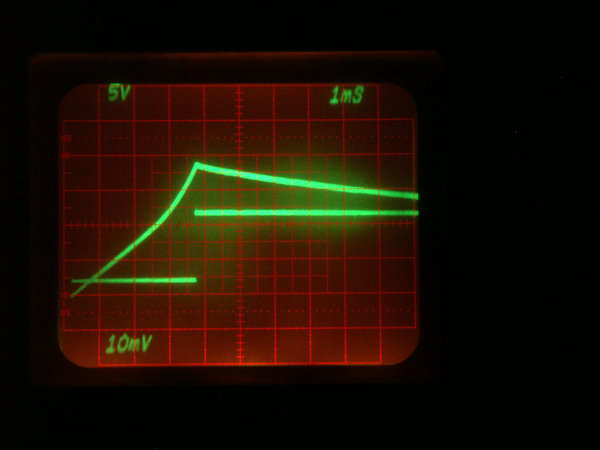

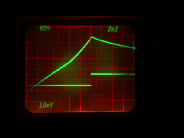

The power supply choke was 30 mH, 7A, .23 ohms DCR. The output chokes were 100 mH, 5A, .74 ohms DCR. Here are curves of the chokes from a curve tracer with a DC step signal.
