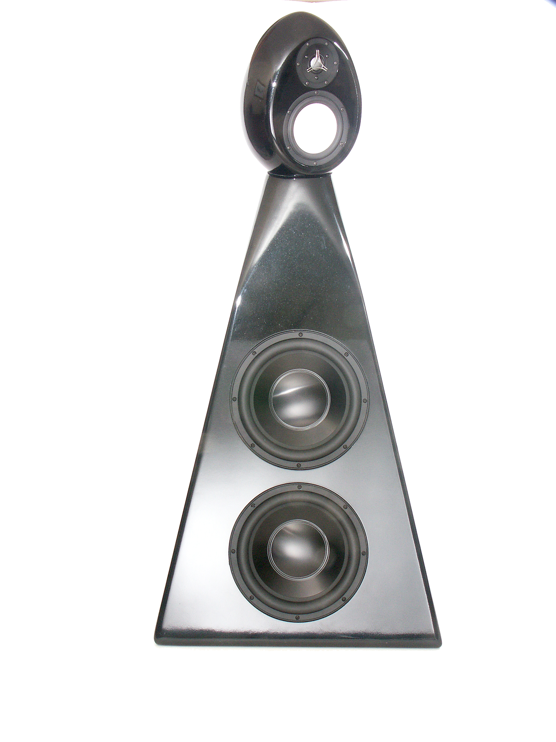

Here is a photo of the finished speaker. The Ara has the same midrange but what I built had the TW29N Beryllium dome tweeter, not the ring radiator.

Very nice speakers! What are the woofers? The SB Acoustics ARA you can have with an upgrade for the Berylium tweeter now.

The woofers are Dayton Audio 12 drivers from the HO series. I chose them for several reasons. First, the VAS is fairly low which allows them to work well in a medium sized enclosure. They achieve that VAS and at the same time low Fs by having a high moving mass and low compliance. That usually results in low sensitivity but in this case the very high BL of nearly 27 TM results in reasonable sensitivity especially considering that two are used in parallel resulting in a sensitivity slightly over 90 dB at 2.83 volts. I'm including a link to the driver page.
https://www.parts-express.com/dayton-au ... r--295-467
It is good to hear that the beryllium tweeter is offered in the ARA kit. I'm assuming the crossover is changed in that case as the sensitivity of the beryllium tweeter is higher than the ring radiator version according to the spec sheets.
