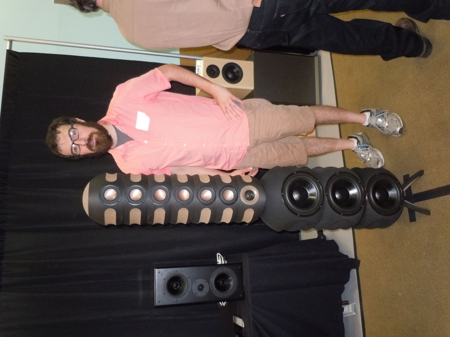

PostPosted: August 8th, 2016, 7:34 pm
Has any of you tried to make a diy horn (especially the critical throat region) with a 3d printer.
This speaker was one of the entries at this year's Midwest Audiofest design competition. Although not a horn it was done with 3D printing. The upper and lower sections were done with different materials added to the plastic to achieve different densities. It sounded quite good. I'm sure someone could build a horn that way.
