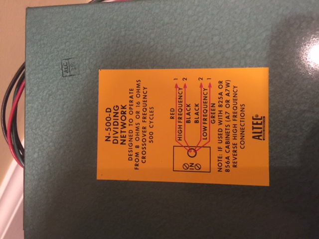

Reversing the polarity of the horn as suggested by the N-500D crossover made it lot soother.
