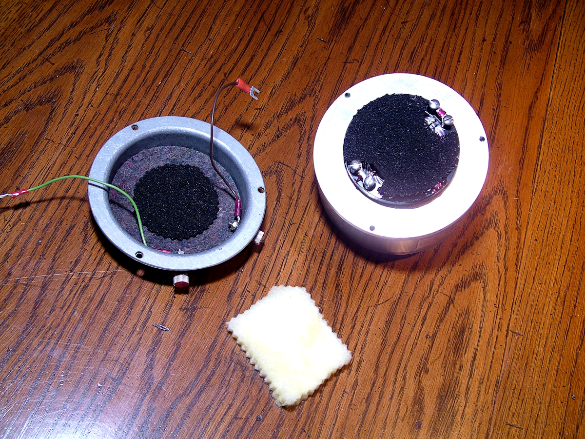

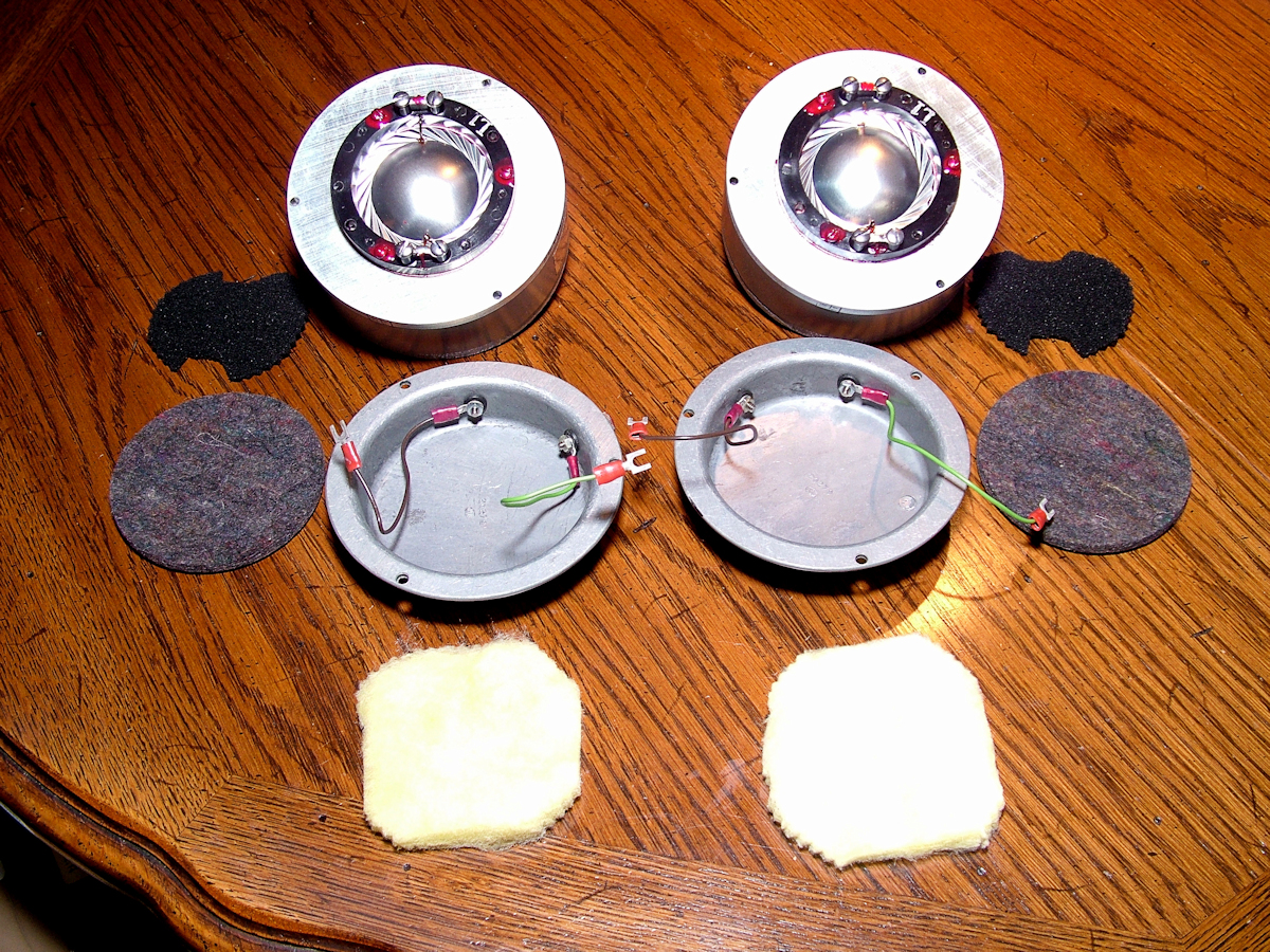

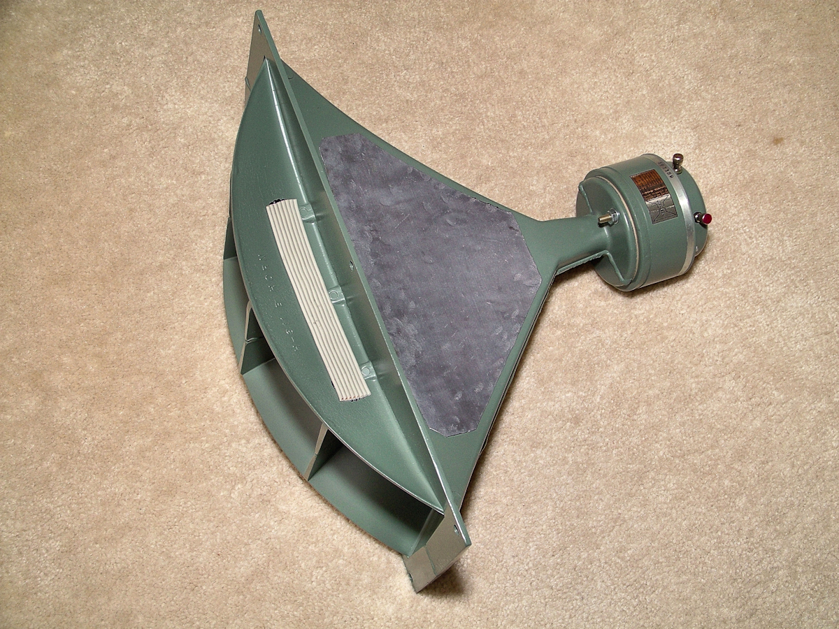

Instead of trying to compensate for the horn behavior with a "band-aid" approach you might consider going after the horn driver itself. See photos attached.
Tune the cavity as you would a speaker enclosure, drill two 1/8-inch holes in the back to relieve the cavity resonance by venting the cavity -- and you will find much improved sound quality.
Also, the horn itself can be addresses with constrained layer damping and tying the sectoral blades together.

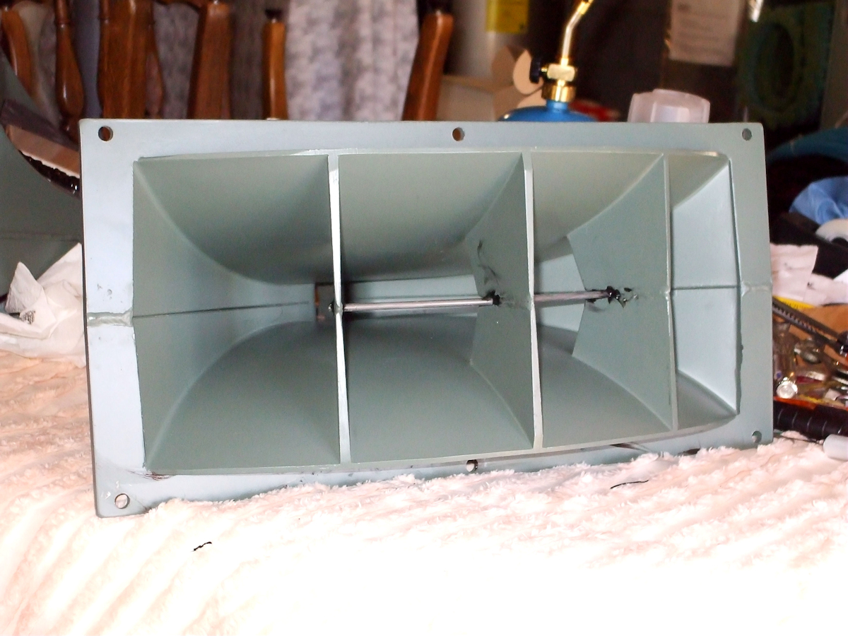

Here are the images for the horns themselves -- note how the sectoral blades are interconnected. When all else was done the blades themselves were contributing a metallic coloration.
Tying them together with shrink-wrapped steel rods did the trick.

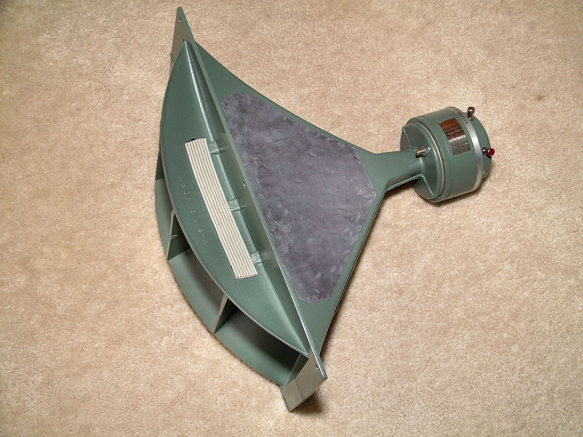

The horns can be tamed. The shape of the horn flair is based on logarithms so there is no resonance per-se. But the horns are made from sand-cast aluminum in halves that are welded together.
Damping comes in different flavors. Using coal tar or other similar soft materials does not get the job done. Like I said -- constrained layer. In the example I attached it was not actually finished as the lead sheet alone was not sufficient. I don't have a picture to share, but I later added ceramic tile attached with RTV silicone caulk creating the constrained layer. Tying the sectoral blades together is more important than I thought possible. Part of getting rid of the horn driver cavity resonance is venting. I can't begin to emphasize the importance of the venting.

Tying the sectoral blades makes sense. They are not needed for the structural integrity of the horn itself. They might have been designed to reduce the vibrations (ringing) of the lips of top and bottom halves of the horn, and by bracing them, you are further reducing the vibrations.
BTW, I met Bruce Edgar in CES in Las Vegas several years ago (his horns were my top choice in the show). He mentioned that he uses truck undercoat to control the resonance of the horns.

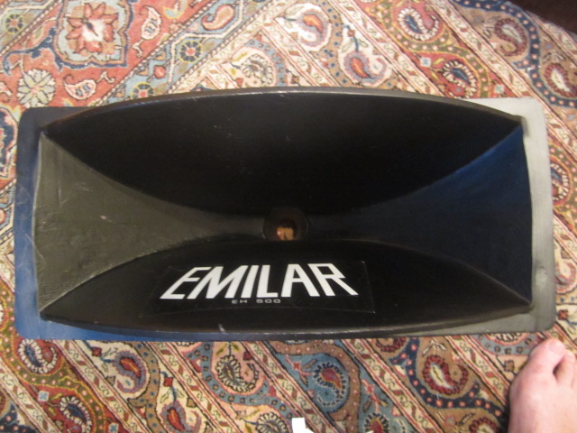

The problem with the Altec 511 is that it goes from round to square throat very abruptly--WHY?, very roughly cast especially in the throat where it matters most, and then opens up to a wide expo flare very abruptly which is a diffraction generator.
The throat should be smooth and regular ideally. This is a super high compression area and geometry and surface regulariity matters.
Mechanical ringing is a secondary issue and simply bolting the 511 to a baffle solves a lot of that.
The issue I'm hearing is acoustic.
The earliest 811s had the vanes cut (or rather never welded) and they stuck in some rubber to damp bell effect. You can see the fossil of this idea in the earlier 511s where most of the slot still remains, but it is welded instead.
I am a huge Altec fan...been using the stuff since 1985 continuously, I published articles on Altec before it was cool, I started the Altec users Group...and still I must rag on the 511. It was designed for cheap production, which is not necessarily bad, but there are deficiencies in the fundamental design.
What needs to be done is to fill the throat and rebore it to a more accommodating geometry and surface and there is still the refractive throat/bell transition. Hopeless.
But they do have a certain liveliness... and high intelligibility in paging applications.
When I say they are fair at best, but that is in comparison to many better horns. There are also far worse.But some of the very good ones were current within a decade of the introduction of the Altec sectorals, so they should have known better. Probably comes down to manufacturing economics somehow. They spent the cash on the driver and cheaped out on the horn.
Late model 511s look like they were cast and welded in India. Rough welds and flash inside, Niot precision instruments... but OK for generic PA, perhaps.

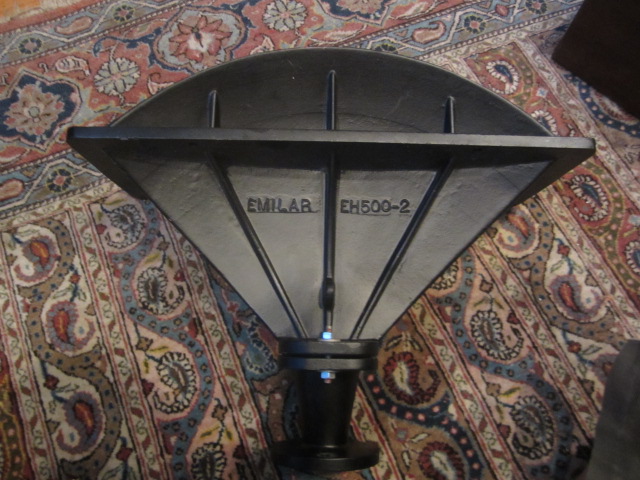

Now here is a good 500hz horn, the Emilar EH -500. Designed by Jonas Renkus after he left Altec and intended as a bolt on retrofit/upgrade for the 511. It is a heavy casting. Very smooth throat that gradually opens...in fact without the 1" adapter, there is no throat extension on the horn for a 2" driver. You can see the diaphragm, as it were, from any point inside the coverage angle of the horn.
The later Renkus Heinz horns were like this too, and the RH and Emilar drivers had only about 1" of throat. between the phase plug and the horn mouth. The throat is a trouble spot. Renkus minimized it.
I don't talk about these horns too much. Word is already out somewhat, but you are my DCDIY bros...and Joseph Esmilla will probably tell the world next week anyway :lol:
Sadly, they are not super common, especially with the 1" adapter.
Sorry about my ugly toe in the pic!
