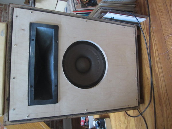

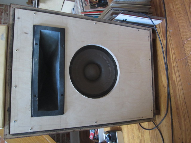

Here's what your old cabs look like now...cut for 12" and 32 horn.
You would need to clean up the 32 cutout, which I screwed up a bit with an underpowered trim router.
Put the grill frames and grill cloth on, paint with chalk paint, and this would be pure Martha Stewart
I want to try to get somebody to build new cabs for me for this project. Found a possible woodworker dude on Craigslist but if anybody has suggestions...
