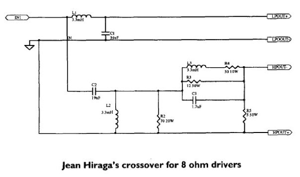

Yeah, that is the only graph I could find on short notice, but the sub 8k region looks about right,.
Altec 288s have the same broad peak, addressed in the so called "Hiraga crossover" which adds a series LR in parallel to the standard EQ scheme. See attached schemo.
Anyway, something to consider but if you are happy with what you have, hang out there for a while and learn what it is.
