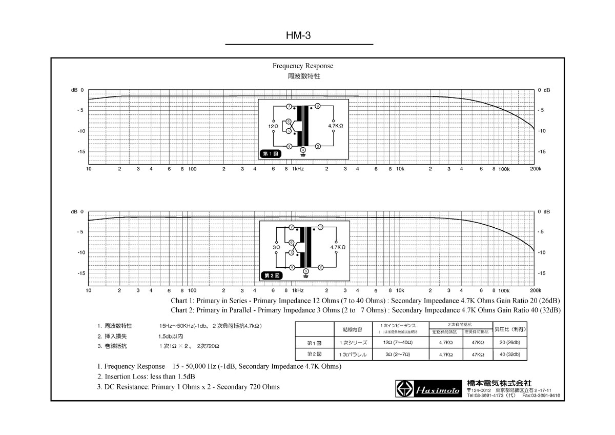

Actually, I'm thinking about building a SUT for my Denon 103R. Just haven't figured out how to yet (e.g., which transformers to use, what other parts are needed, etc.). Thanks for the welcome![/quote]
A few of us have Hashimoto SUTs. I have HM-3s, Roscoe has HM-X and I think Charlie has HM-7, IIRC. They are all excellent, the '7s being the best.
Be sure to load the Denon heavily, no more than 100Ω, much lower works well also, to tame the HF. Resistor quality is critical here.
Good luck
