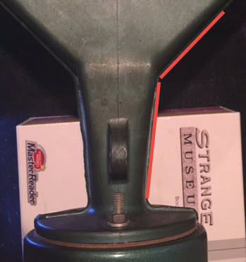

After some reading, there is some misunderstand -- at least on my part -- about 511s.
Altec 511Bs are not exponential horns. They are Radial/Sectorial horns, ie, exponential vertical axis and canonical horizontal axis. No part of the horn is strict circular except for the start of the throat.
The quote above from Altec, "Exponential expansion and straight throat", gave me the impression that throat is straight like a tube which suddenly flares into a canonical horn causing diffraction. If I look at the horn closely (see pics below), the throat quickly becomes a rectangle and slowly flares until the a point where exponential and canonical geometries kick in. The "straight throat" in Altec specs is referring to the vertical walls of the throat, which are supposed to be straight because of the canonical geometry on the horizontal axis.

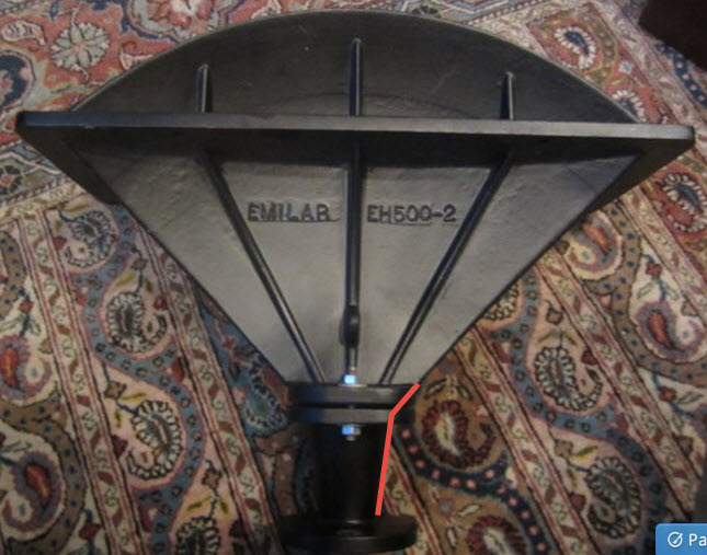

The flare looks too steep from outside, but it is similar to that of Emilar EH500. Inside of the horn, the transition from throat to mouth is nicely curved.
The horizontal walls of the throat follow the exponential curve and they condense at the beginning of the mouth to start a new exponential pattern. This also looks to be very similar to the pic of Emilar EH500 (J-ROB, can you post the horizontal axis pic when you get back?)
Since the throat is the sectoral horns is expanding and there are no sharp edges, I now do not believe that our hypothesis of simple diffraction does not apply here, that is not to say there will be no diffraction in the horns. What ever little diffraction is present in the sectoral horns is inherent part of the geometry.

The situation looks a lot different from the inside of the horn. External measurements are going to be misleading.
The EH500 is actually quite a smooth expansion inside, with a lot of thick metal around it.
One thing that give me cause to worry with the 511 is the extremely rough casting and welds inside the throat of 511s. This can't be good. Seems they got worse over time. These rough spots will give rise to classic sharp-edge diffraction it seems to me. Maybe no big deal for PA but for nearfield hifi?
I should qualify this by mentioning that SOME 511s are much nicer than others. The gold ones that were intended for hifi systems were much more nicely finished than many of the generic black ones, especially late production. But even the gold ones have a very rough texture inside the throat where it should be as smooth as possible.
Aside from the mathematical design, there is always the question of implementation.
