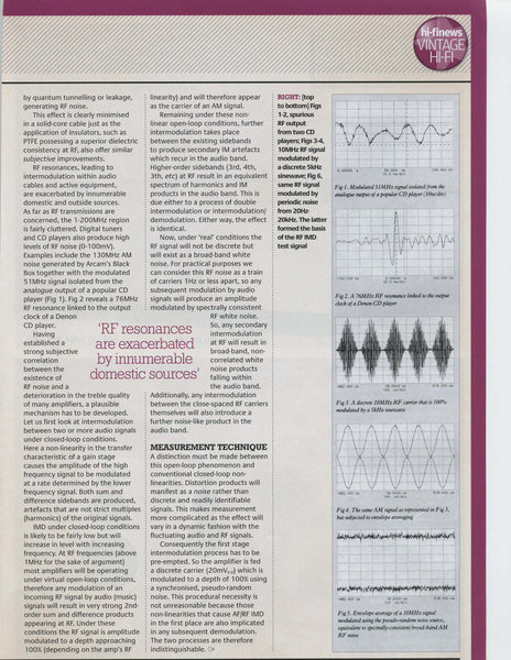

Many of you know me and some of you have auditioned my music system. That said you may also know that I am particularly careful about isolating my system from RFI/EMI infiltration through an isolation transformer, input power filtering, and ferrite filters on cables. I have had a difficult time explaining how these things are important other than it definitely has an impact on sound quality -- all for the better when implemented.
Paul Miller, the editor of Hi-Fi News & Record Review, a British publication, published the results of his study with his findings that was originally published in June 1989 and reprinted in the recent June 2017 issue of the magazine.
The article is comprehensive and loaded with what I call "word salad" but it is quality word salad to say the very least. Paul's findings confirm my experiences with keeping the interference out of the signal path with the end result of better sound.
I knew the multiple isolation methods that I have used works -- but the reasons and how RFI/EMI infiltration actually impacted the electronics was beyond my knowledge base.
Paul "'splained it to Lucy." After reading his piece my first reaction was "OMG!" RFI and EMI is like electronic "roaches." They get everywhere in the electronics and and effectively mess with the delicate audio signal.
Attached are pages 1, 2, & 3 (The full size <*.pdf> file would not be accepted) Page 4 to follow.

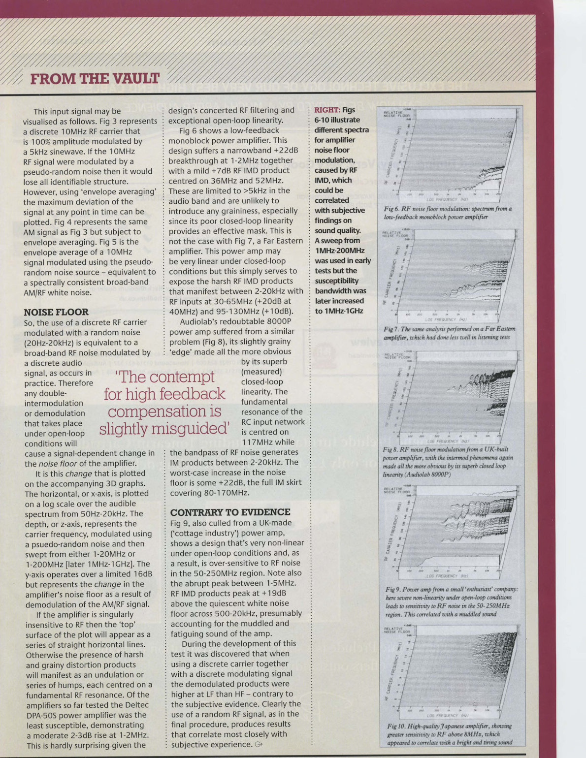

Attached is page 4 (The full size <*.pdf> file would not be accepted)

Can this noise be seen on a Oscilloscope?
PostPosted: November 26th, 2017, 12:26 pm
Look at the images in the article. That's how Paul Miller developed his findings.
