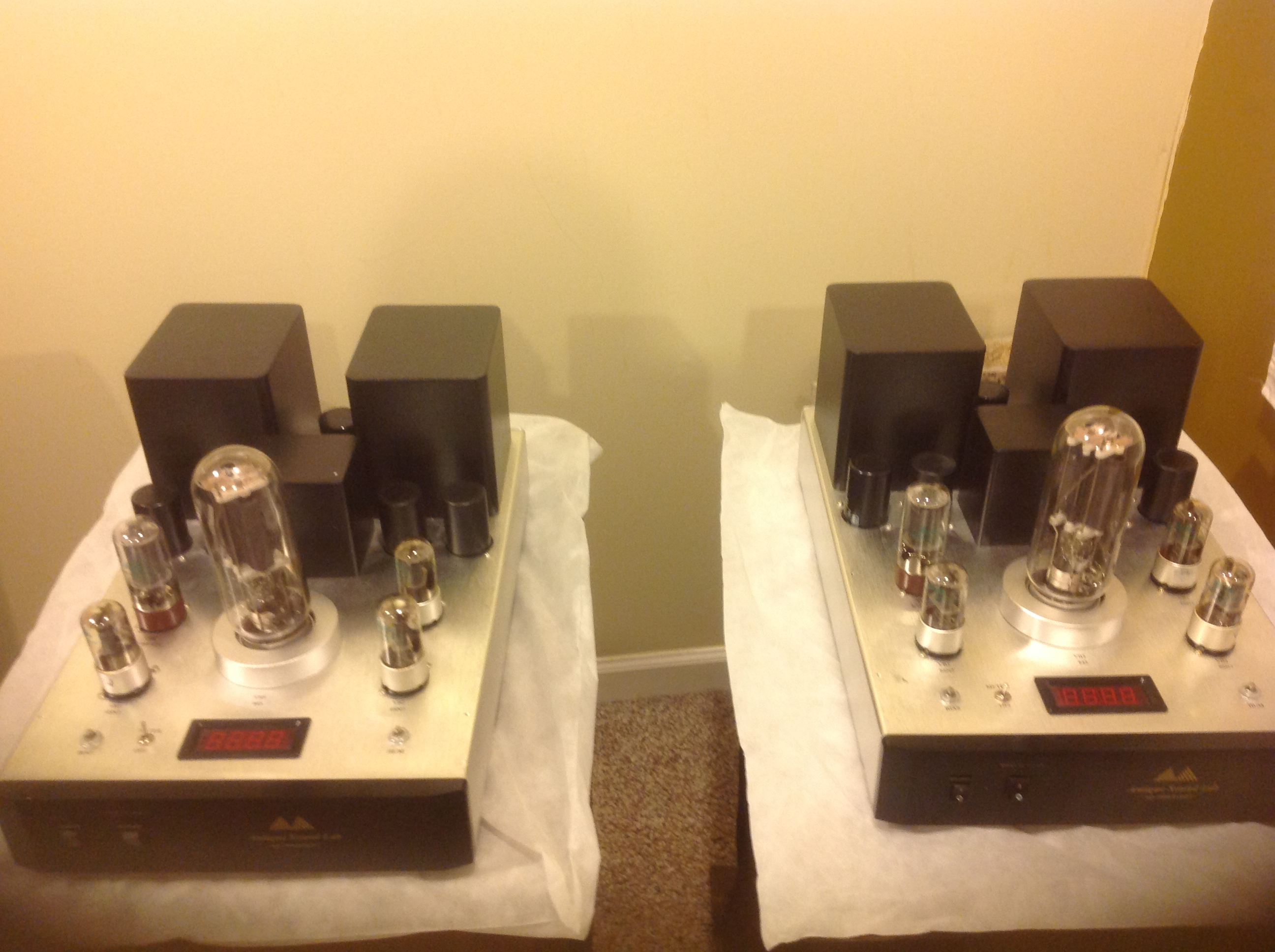

Hello.
I have a pair of ASL AQ-1006/845 Antique Sound Labs monoblocks and both died at the same time. I replaced the blown fuse and upon power on, they come on for 1-sec then shut back off - it blows the fuse. I don't smell anything burning. Roscoe suggested I post this to see if anyone wants to replaced whatever is failed. I'm in Bowie Md, so someone local to the DMV would be great.
Patrick

PostPosted: August 2nd, 2013, 11:31 am
Both Monoblocks failed at the same time? What is the wall voltage? Did you replace or swap out tubes before this happened?

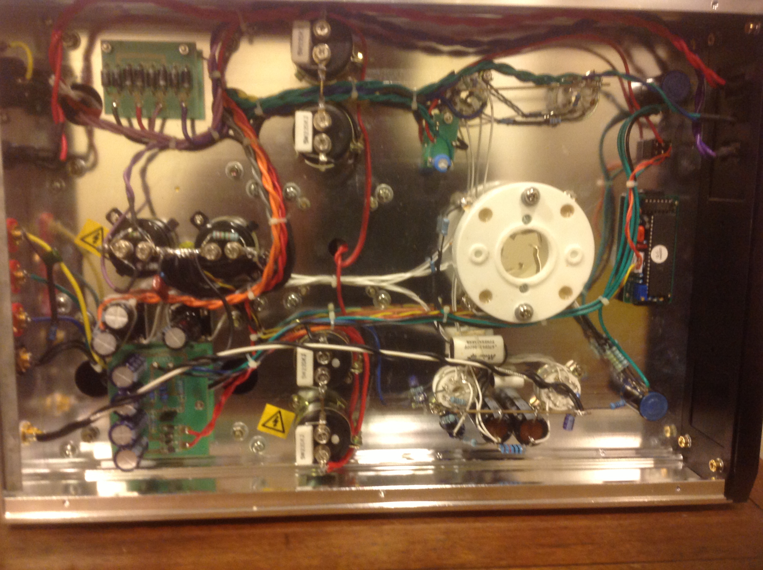

They have not been siting. They were working 1-2 days prior to failing. They were plugged into the wall. They longest duration of off/idle was about 48 hours.

PostPosted: August 2nd, 2013, 3:13 pm
It is odd that monoblocks would fail at the same time. I wonder about a power surge that shorted a small cap across H and Neutral or maybe fried the SS rectification?
