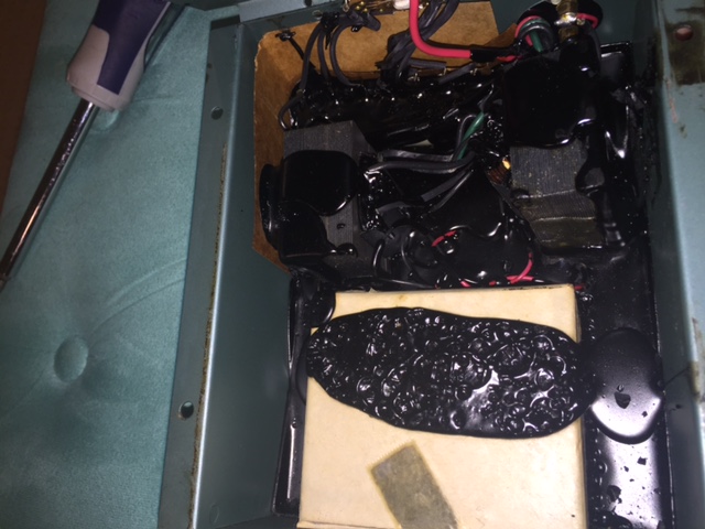

this is the photo of Altec N-500-D crossover used in VOTT A5 systems. I was using them with 9846 2-way monitors. Could not identify that square white box. Looks like it is made of waxed paper.

Altec liked to use coal tar for physical security to keep things in place -- with the side benefit of acoustic damping.
The box (I am pretty sure) is a multi-section paper capacitor to go with the inductors I see in the picture to form a second order crossover.

yes, it is a 2-order crossover supposed with crossover point at 500Hz. Even if I consider its 2 caps in a single package, they are big. Wonder how the compare sonically to new gen caps.
