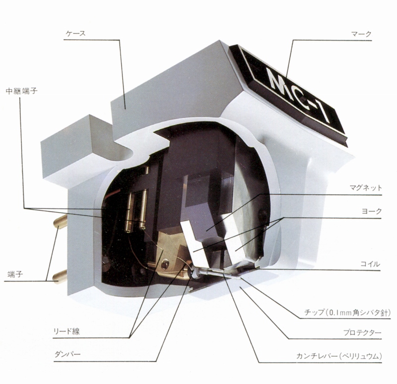

The new Audio-Technica direct-scan cartridge that Stereophile swooned over is a direct descendant of the Victor (JVC) cartridge that was introduced in the '70s. The Blumlein and Neumann cartridges being the first of this design.
[color=#BF0000]The difference being that Victor has tiny printed-circuit micro-coils bonded to the top (close to the stylus) of a solid tapered Beryllium cantilever.
The Audio-Technica took the path of a more labor intensive hand-wound micro-coil bonded to a solid Boron cantilever.
Common to them both are very powerful magnets.
Sound? Ask the man who owns one. I have the second-generation Victor (JVC) model MC-5E and it surpasses any other cartridge that I have had in my system -- moving coil or moving iron. The list of "defeated" cartridges includes Allnic, Clearaudio, Koetsu, Ortofon, and Denon to name but a few. All of my cartridges have been "hot-rodded" by yours truly -- all performed to expectations until this damn direct-scan cartridge came along. It has spoiled me for anything else. The Allnic is the closest to the Victor (JVC) and is constructed in a way similar to a cutter head to read the grooves.
The Victor (JVC) is natural with the breathe of life -- fast -- will track anything I put under it -- and when the music goes loud and dynamic this gem just goes along for the ride like it is no big thing. No strain.
The Decca cartridge was mentioned. It is not the same thing. The Decca is a moving-iron cartridge that plays the sum-and-difference game to decode stereo. The Audio-Technica and grandpa Victor (JVC) are true 45/45 cartridges.

There is one on eBay. A Victor (JVC) MC-1 is being offered for $399. Just like the one in the images I attached.
