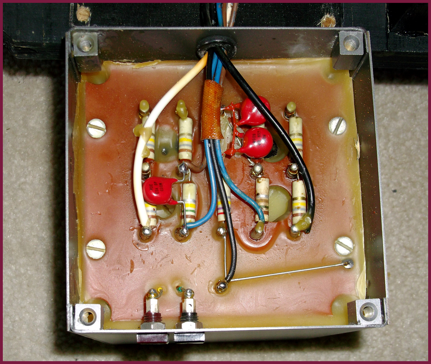

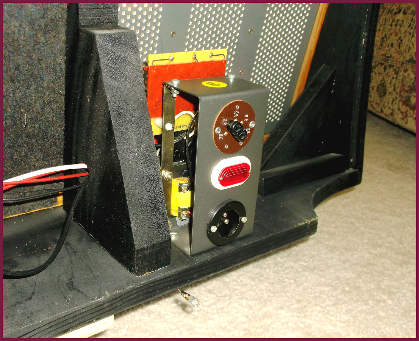

File comment: Quad 57 ESL HV Bias Supply Installed

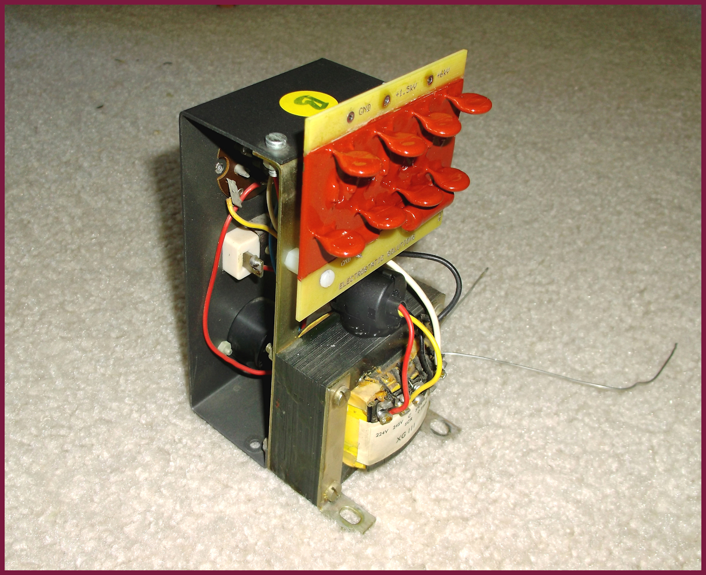

File comment: Quad 57 ESL Replacement HV Bias Supply
File comment: Quad 57 ESL Upgraded Audio Module
