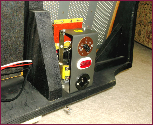

I had a brief listen at Walt's after he repaired a friend's pair 57's that needed power supply rework and work in the very weird xover circuit.
The Quads were stock and in very good physical condition.
The sound was glorious, bested anything I heard in a long time

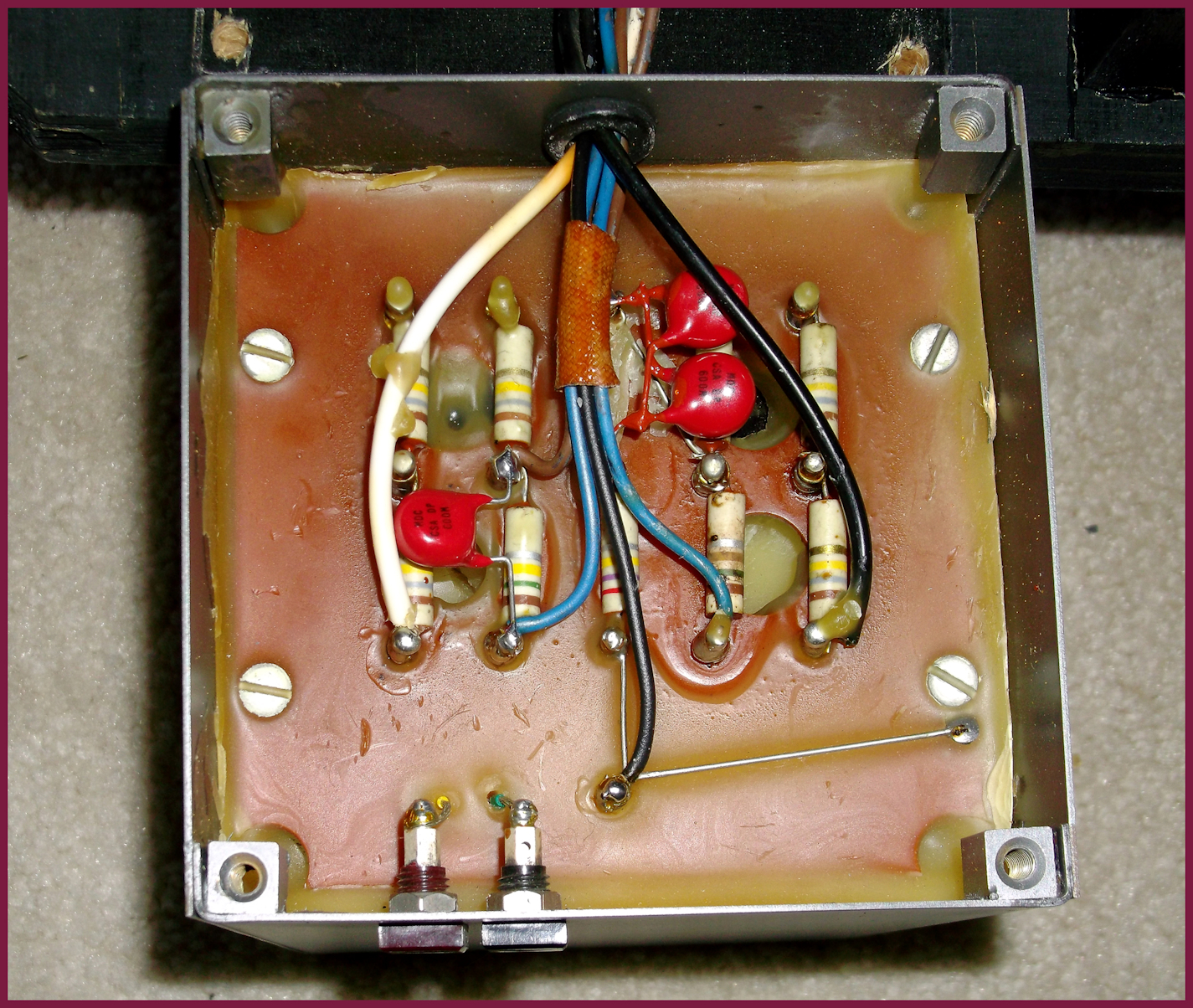

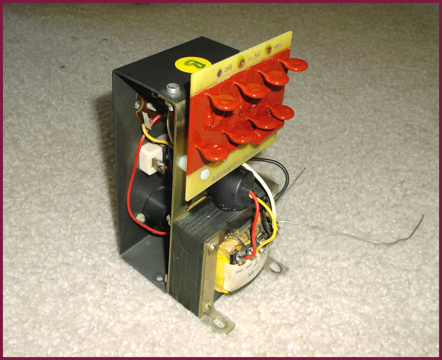

The Quads were a pleasant surprise for me when I was finished the work and just listening. They were dated September 1969.
The Quads are beyond transparent and sweet -- they are not there at all. Very remarkable for a design that originated in 1954 and was tweaked in 1957 for stereo.
Modifiers out there are ruining the Quads. Peter Walker for want of a better description of his talent was a genius! Other than better 560-pf caps in the audio modules, the Quads that I worked on are stone stock.
My amps.? Modified Cary CAD-805C Rev. 1 amps. Cetron 845s, driven by Psvane 300Bs, with gain provided by cascoded G.E./IBM 0528s. Although the Carys can push 50 watts the Quads did not need that kind power to blossom.
I can't wait for the owner's reaction tomorrow when he auditions these beauties and takes them home. They will be missed.
File comment: Quad 57 ESL HV Bias Supply Installed

File comment: Quad 57 ESL Replacement HV Bias Supply
File comment: Quad 57 ESL Upgraded Audio Module
