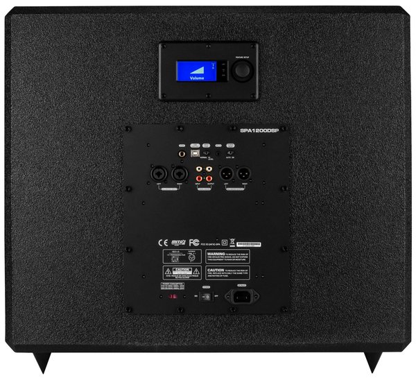

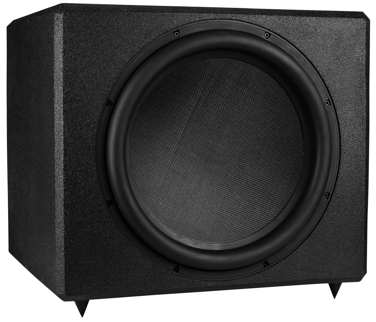

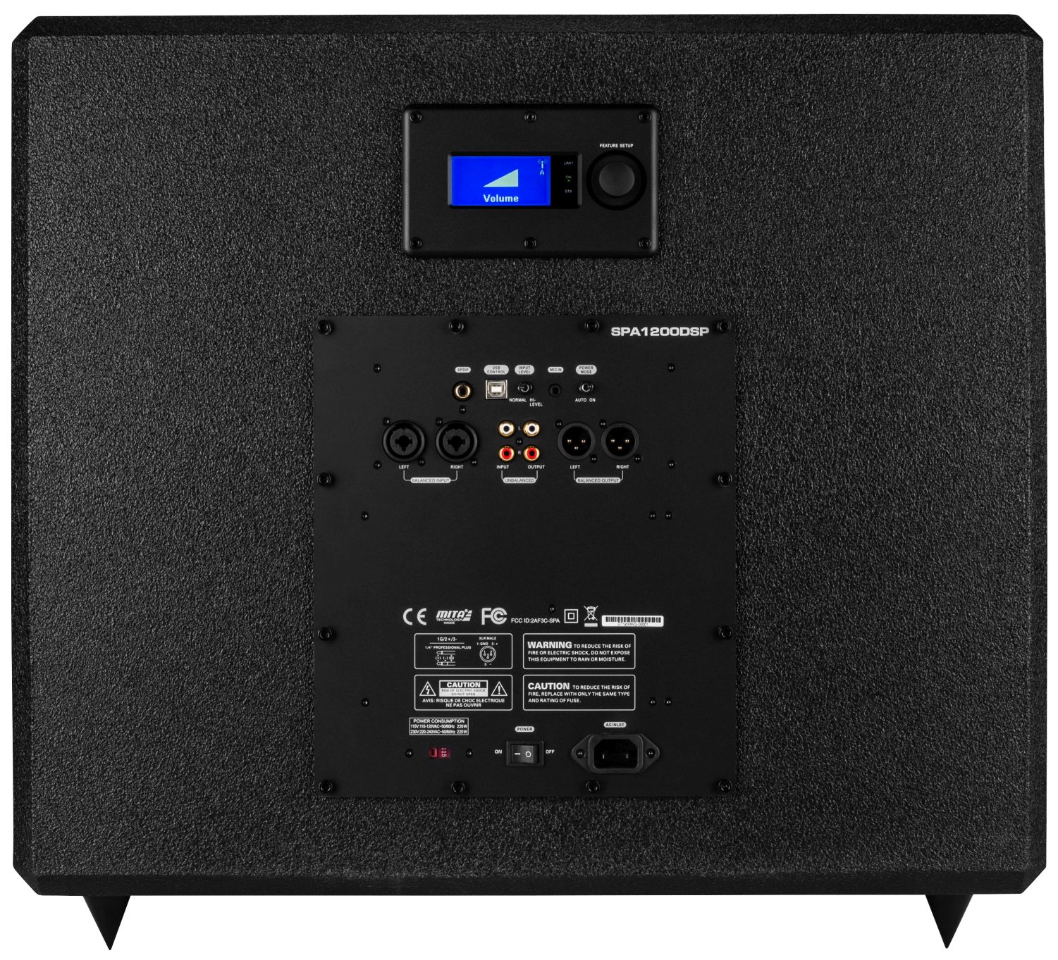

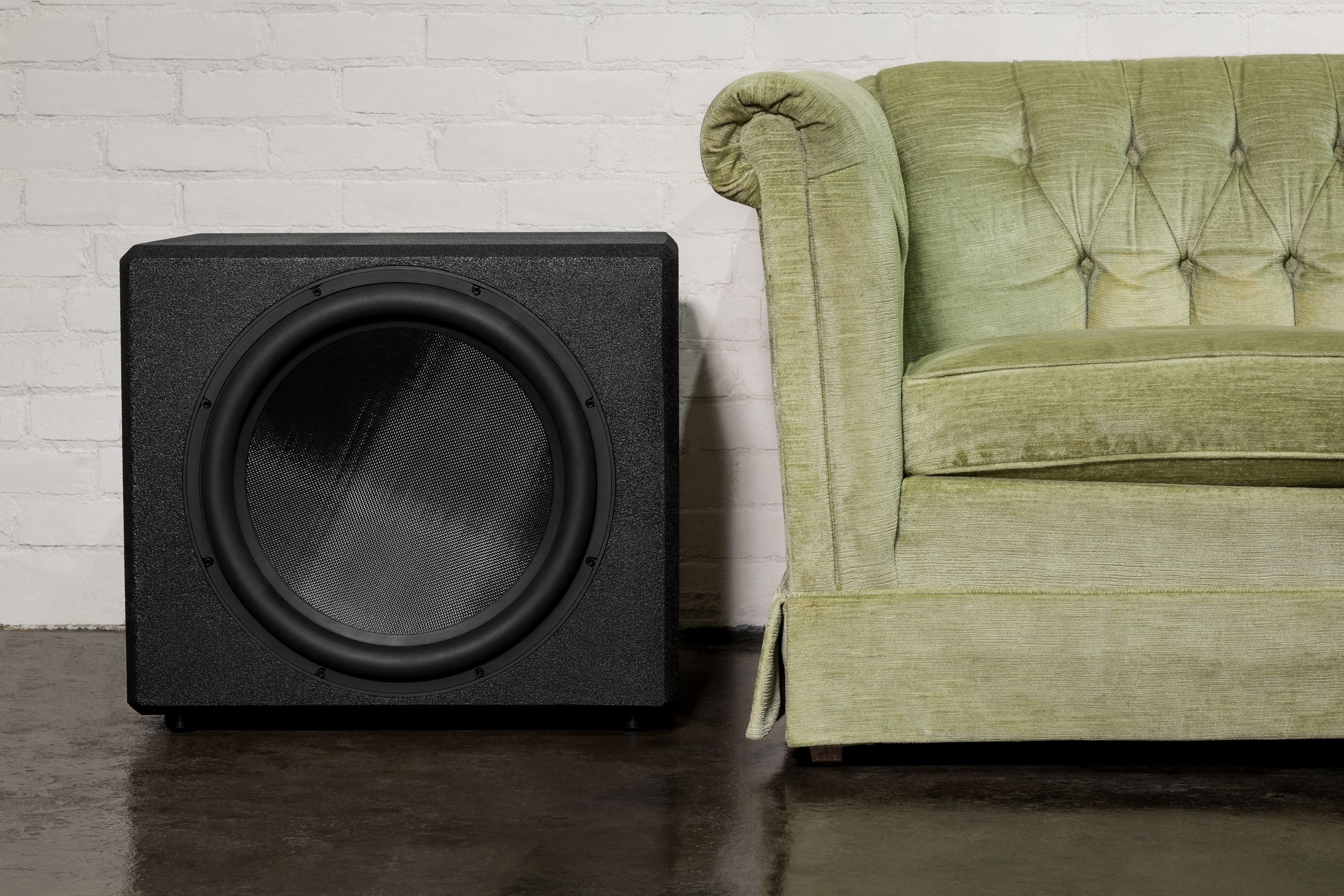

Parts Express just sent me the new Ultimax 18" sub for testing. It is a monster that comes in a kit with enclosure and 1200 watt class D amp with DSP. I have not had a chance to do complete testing but the closed miked distortion at 100 dB is the lowest of any low frequency driver I have ever tested. Not surprising because it is 18" and has 22mm Xmax. One of the interesting things I have seen is that if you put in the full range signaleither analog or digital the pass through to the main speakers is not just a straight connection or a simple one capacitor fixed high pass. Rather you can select the crossover point and slope of the high pass with the DSP. I should have the testing and the comparison to two of my 15" sealed box subs done this month. In theory one of these should be the equal of two of my subs in a box considerably smaller than two of my current subs. The photos do not do justice to seeing it in person.

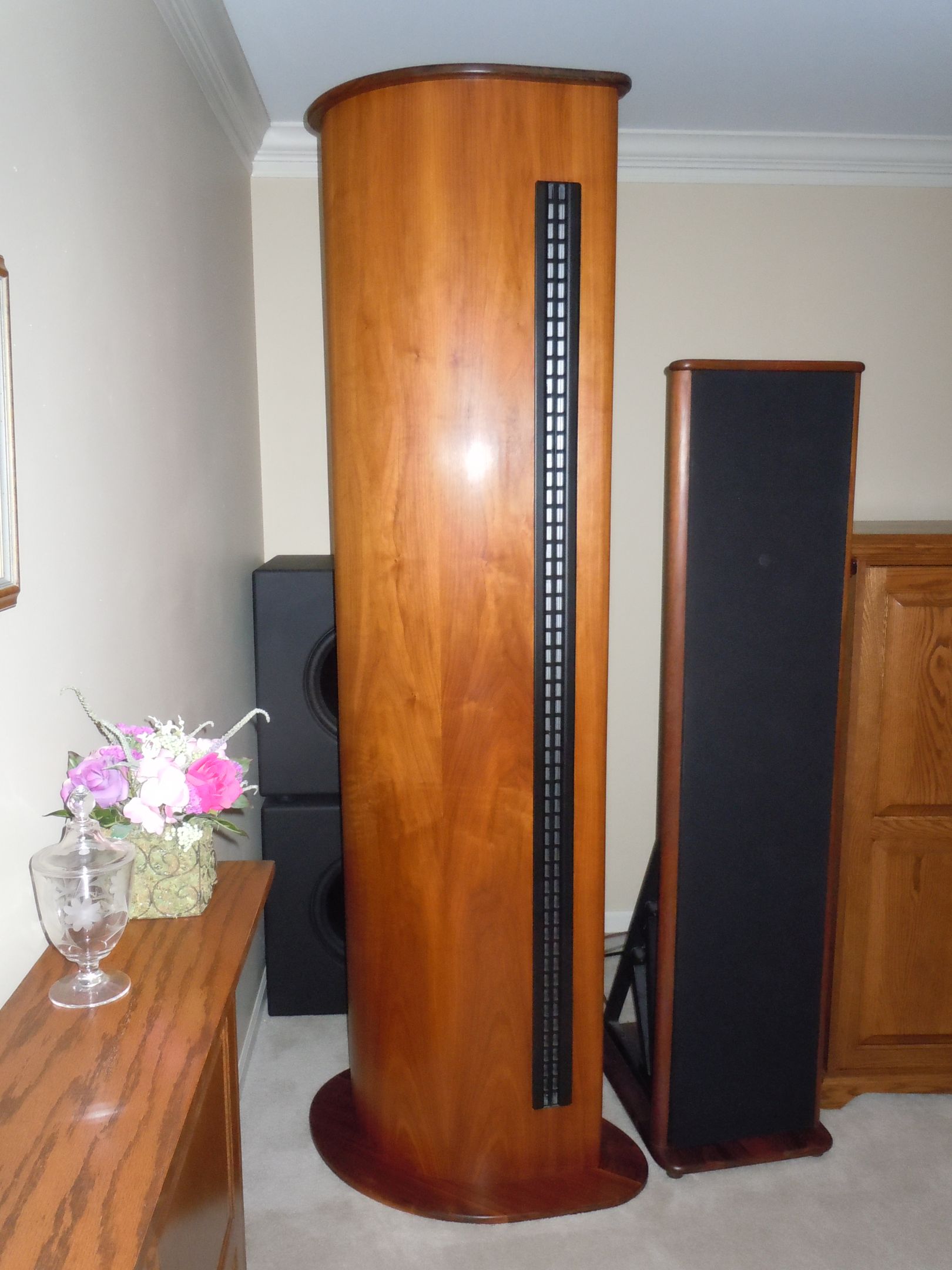

I'm not too woried about the QB of a sealed box sub because I use DSP to correct any anomalies in response that occur with a QB that is not optimum. It also allows me to compensate for room gain or lack thereof at low frequencies. There are a lot of conflicting opinions about placement in a room of any sub or combination of subs regardless of enclosure types. The predominant thinking is in the corners at the floor or the middle of the walls at the wall/floor interface. I have always used the corners. I have to say that my current listening room is one of the worst I have ever had. That coming from a great room in my last home. It is frustrating. Using electrical eq is OK at long wavelengths but not effective at shorter wavelengths. Here is a photo showing the placement of one pair of my subs in the room. The subs are in the other corner at the right side but the two dipole driver arrays are not the same distance from the wall at the right side because the room has a window on the right side that caused some problems, That necessitated some interesting phase and timing corrections. Everything is always a compromise.
