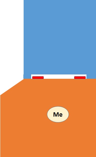

I've tried the Joachim Gerhard method before, with speakers toward the middle of the room (not directly on the nodes) and the listener all the way up against the back wall, and it works pretty well......
My current setup is dictated by my open-plan living-dining room pair. I have my dipoles at the junction of the two rooms.

Posts: 67
[quote="FerdinandII"]I've tried the Joachim Gerhard method before, with speakers toward the middle of the room (not directly on the nodes) and the listener all the way up against the back wall, and it works pretty well......
What dipoles are you using and what are the dimensions of your living and dining rooms?
 Post subject: Re: speaker placement
PostPosted: September 3rd, 2015, 12:11 pm
Posts: 309
Martin Logan ElectroMotion ESL
Width of rooms are 13' and 10'. Dining room has ascending staircase to the left (which I didn't show in the diagram), making it seem narrower.
Length is 13' x 2 = 26'
The way in which these dipoles couple with both rooms gives a very nice ambient effect for non-critical listening and the minimal rear reflection when sitting in the listening spot has advantages. I wish I had a little more room on the sides, but the right side is 95% bookcase and the left side flares out a bit, so side reflections aren't horrific.
