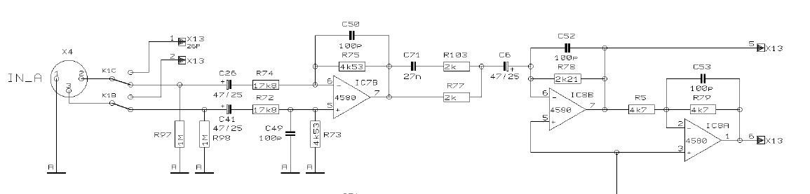

So, off to the web to try and find schematics for the Behringer DCX2496. Had good success, but I don't remember the site I downloaded the .pdf's from. Here is the analog inputs for channel 1 and 2:
Right off the bat, we have a pair of low grade 47uf electrolytic caps with no DC bias loaded by 20K. I was a bit surprised that the electrolytic caps were the cause of the bad sound but then again, I have almost no capacitors in the signal path any where in my system. Further looking at the input circuit we see that the first stage (IC7B) converts the balanced signal to a single ended signal and has a gain of .2. IC7B drives the inverting stage of IC8B. This is where things get a little strange. As drawn, the inverting stage uses C71+ R103 in parallel with R77 as Rin. R78 is Rf. The gain of the inverting stage would be Rf/Rin. At high frequencies, the impedance of C71 is low so Rin ~1K (R77 in parallel with R103). The high frequency gain would be 2.21K/1K=2.21. At low frequencies, R103 drops out of the eqauation and the gain is 2.21K/2K for a gain of 1.1. The thing that bugs me is the active frequency of the C71 R103 combo values is close to 3Khz. Seems strange to have a shelving network in the input circuit. Are the values of C71 and/or R103 wrong? Is my analisis of the circuit wrong? It's been a long time since I tried to do full circuit analisys. Also in series with C71, R103 and R77 is the 47uf electrolytic capacitor C6. At least C6 has some bias (2.5V) on it. The load seen by IC7B is the input impedance of the inverting stage, 1K at higher frequencies in parallel with the feedback resistor R75 and C50. This works out to 1000 in parallel with 4530 or ~820 ohms. Not a nice load for a low performance opamp. To look at the loads seen by IC8B and IC8A it's necessasary to know what is at the input of the ADC.

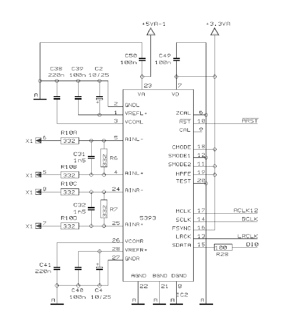

Here we see that the inputs of the ADC is feed from a network of 3 332 ohm resistors. As the signal applied to the network is balanced, each opamp will see one 332 ohm resistor and half of the resistor between the + and - inputs. Effective input load of the ADC as seen by the opamps is 332+(.5*332)=498 ohms. The load on IC8A and IC8B will be the 498 ohm load in parallel with the feedback networks. On IC8A the load would be 498 in parallel with R79 at 4.7K for a total load of 450 ohms. IC8B would see 498 in parallel with both R5 at 4.7K and R78 at 2.21K which comes out to 374 ohms. Pretty ugly loads for the opamps.

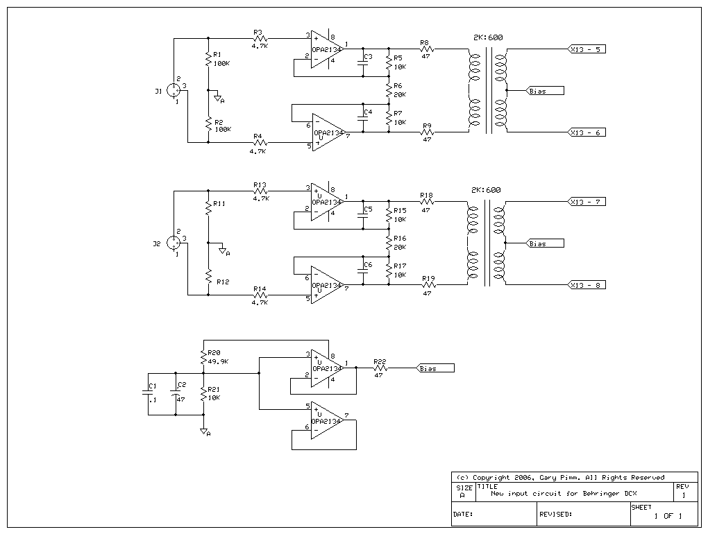

I basically decided that the input circuit was not usable and designed a new circuit that addresses the things I did not like about the stock input. No electrolytics and light loads for the high performance opamps. One of the reasons for the low inpedance of the stock circiut at the ADC is to keep noise under check. The ADC needs to be driven from a low impedance source. Behringer did it one way, My solution is much different
On the input side the input impedance is set by the 100K resistors. the opamps (high performance Burr Brown OPA2134's) are configured as balanced instrumemtation amplifiers with a gain of 2. The balanced input buffer amps drive 2K:600 transformers. The transformers provide common mode noise rejection. The bias necessasary for the inputs of the ADC chips is supplied via the centertap of the transformer secondary. At the ADC chips I removed R6 and R5, the 331 ohm resistors that were between the + and - inputs. In this setup the load on the opamps is very light- just the unloaded transformers and 10K feedback resistors. The 2:1 step down ratio of the transformers provides a 4:1 impedance ratio so from the ADC's point of view the source impedance is the 47 ohm resistors divided by 4 (11.7 ohms) plus the DCR of the transformer windings.
The results of the new input circuit are: higher input inpedance, no electrolytics, light loads on the opamps, and low source impedance for the ADC converters.

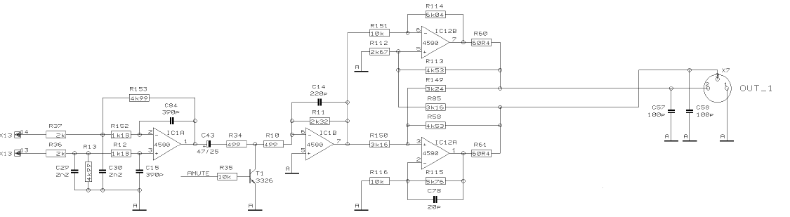

The output circuits of the DCX2496 are just more of the same low grade circuit designs like the input:
Just say no to the output circuits. The easy way for the output was to use 1:1 interstage transformers and directly drive them from the voltage output DAC's. I was already using 1:1 interstage transformers on the output of the Pioneer CD player to great effect so it only seemed natural to do the same thing with the Behringer.

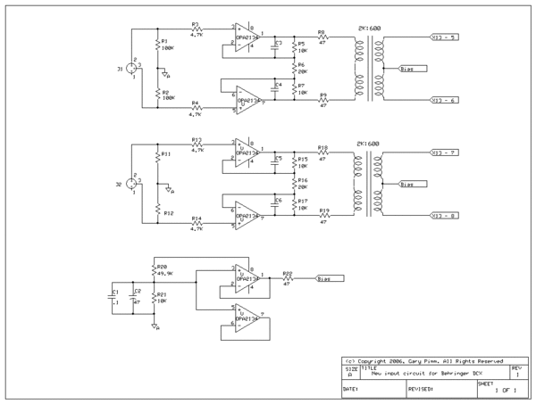

The new input circuit.

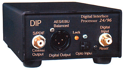

On the subject of AES/EBU, is that a balanced only format?
My Monarchy DIP has an AES/EBU output.
I assume if I input S/PDIF from my PC or CD player, that an AES/EBU compatible signal would emanate? If so, I could use that for my digital playback, right?
PostPosted: January 28th, 2015, 9:41 am
AES/EBU is a balanced signal format. You can interface with unblanced signals using a resistive coupler but the best way is to use a balun. The transformer in the balun assures that common mode rejecton remains high, the desired voltage levels are maintained, and it also provides isolation of the devices. You can get them on ebay for around $30.
