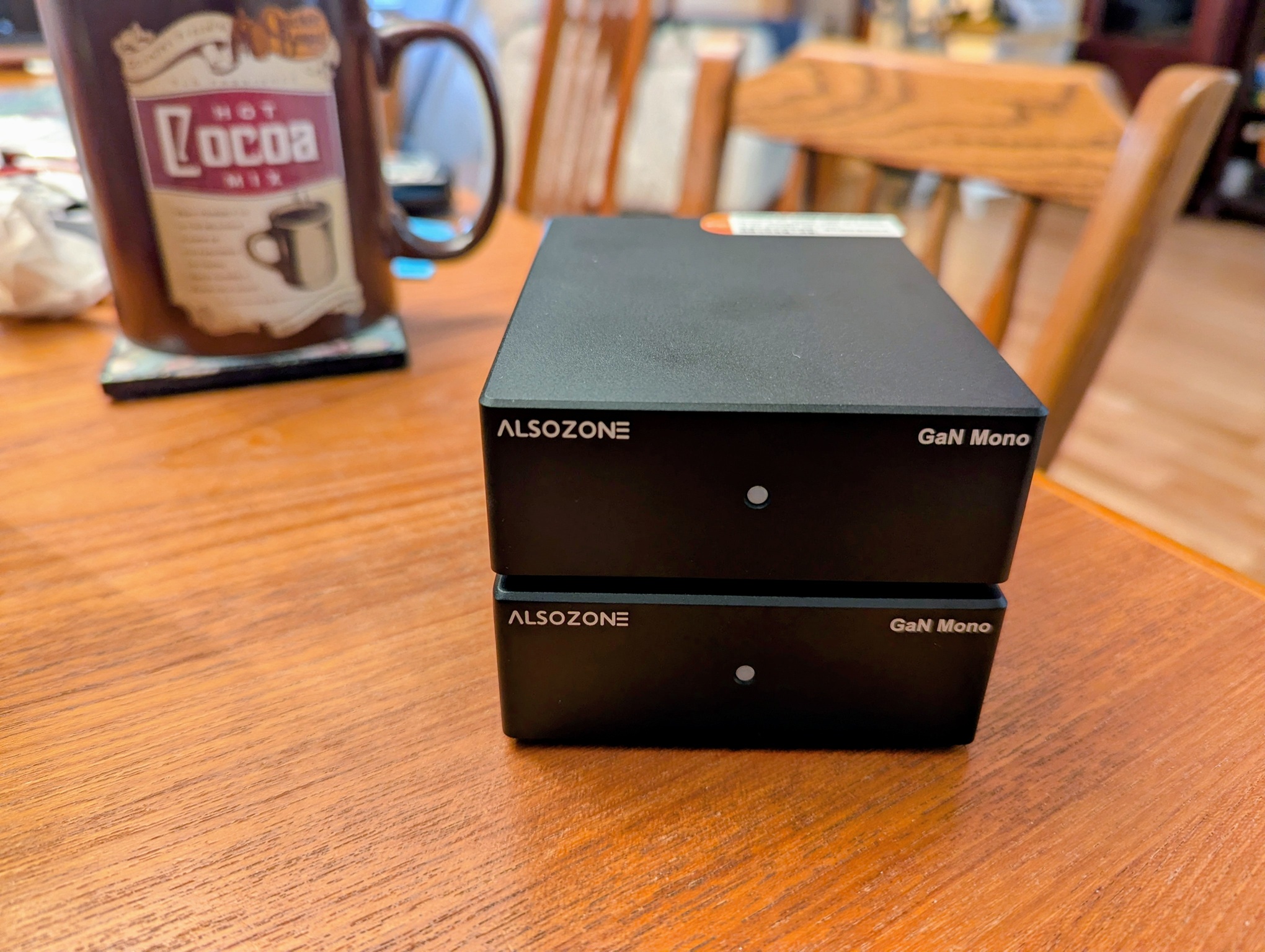

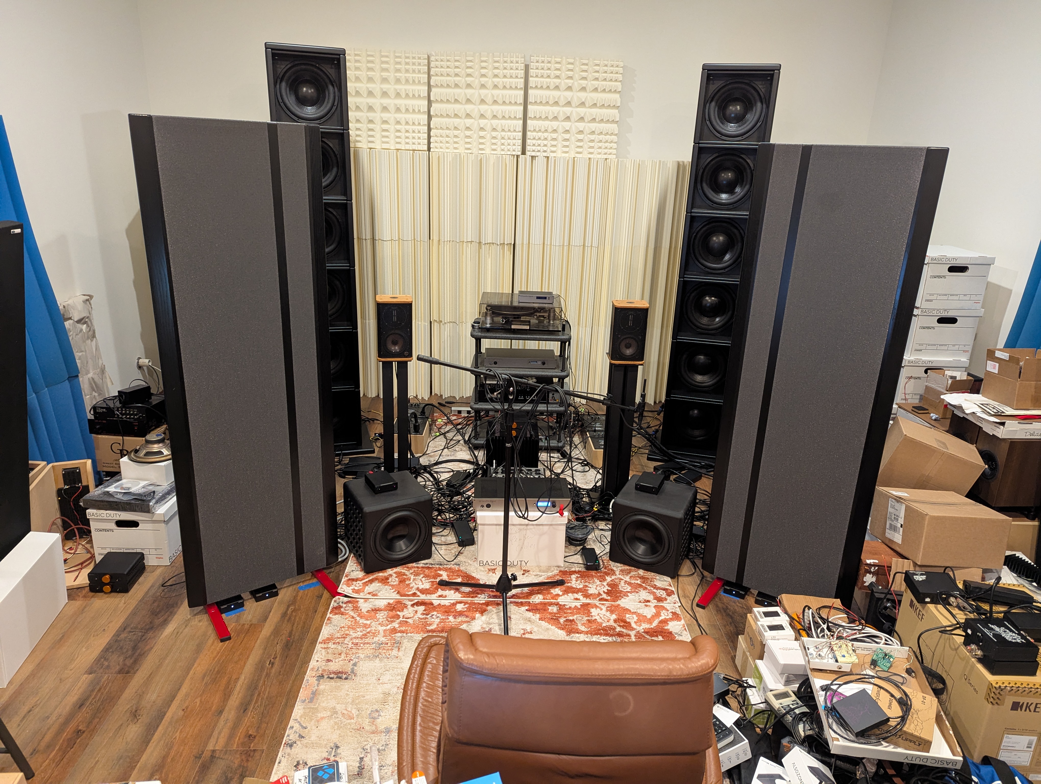

Here are the Alsozone GaN Mono amps and they are setup with my used pair of Magnepan 3.6R speakers biamping them.
Just starting them up, sound better so far than the FOSI ZA3 amps moded with LME49720 opamps replacing the NE5532 originals.
