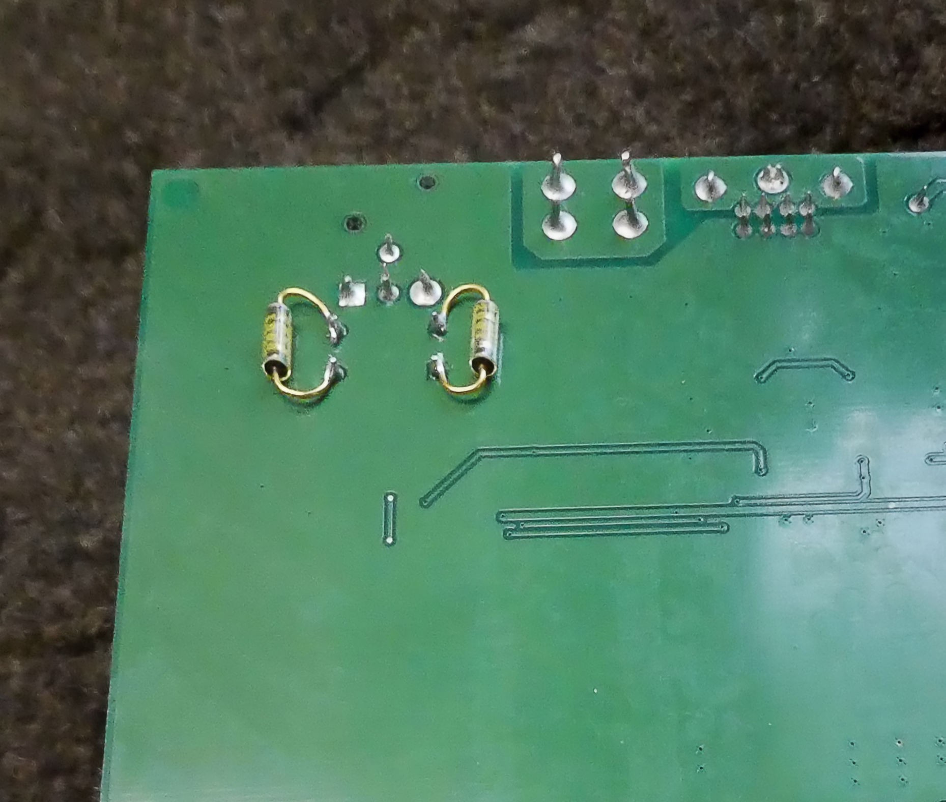

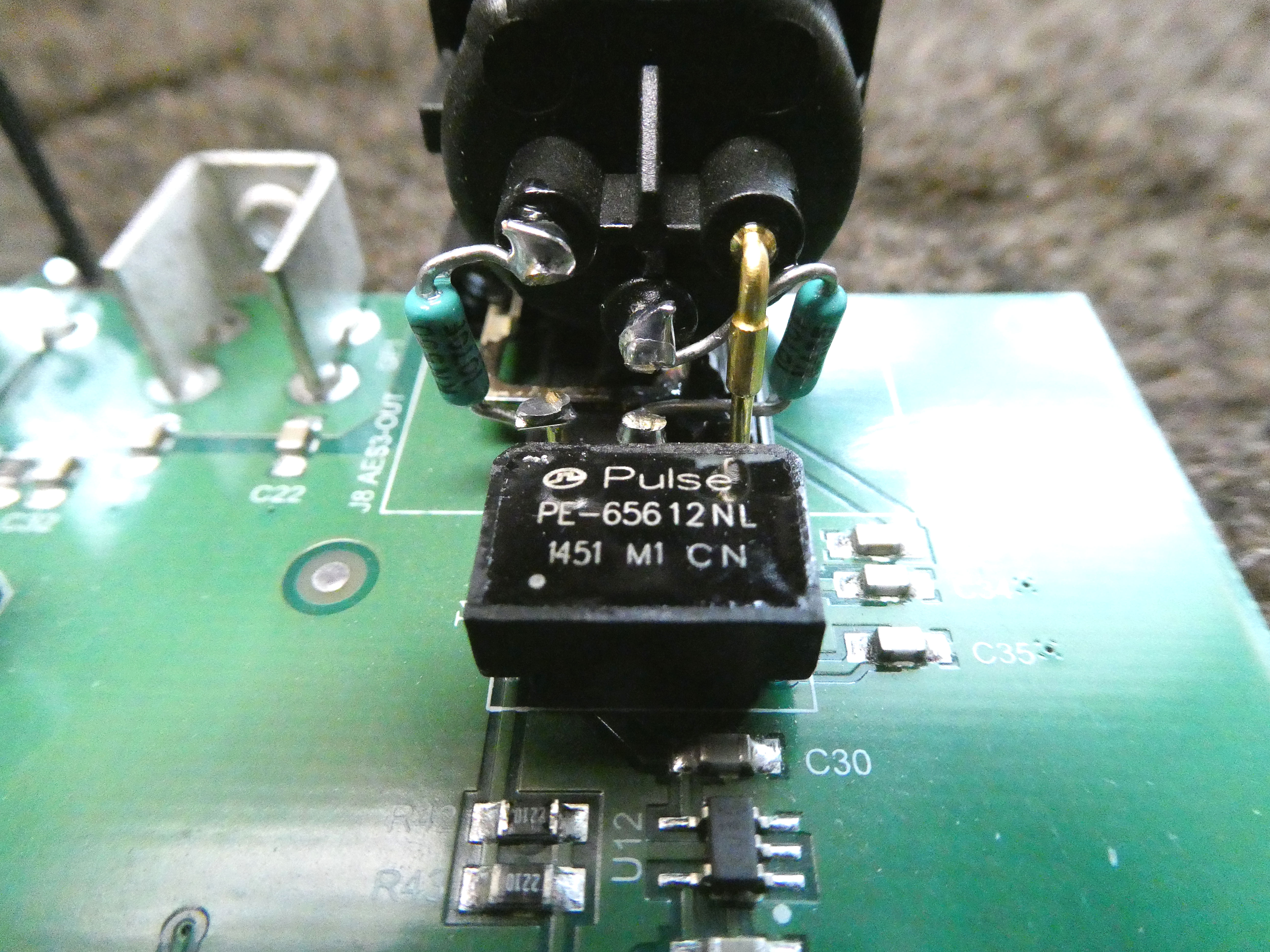

Only if. You may have heard a difference, but I guarantee that it was not an improvement. Galvanic isolation is "marketing speak" for a coupling transformer.
To add insult to injury it is a cheap way to buffer the input or output rather then spend money on an active output-buffer stage or a direct-coupled input stage. During my DIY audio travels, since removing the transformer was not an option (at least not without a major topological change) I found that that the transformers were expected to provide impedance matching say for the 110-ohm AES/EBU standard or the 75-ohm S/PDIF standard. Yet when adding resistors to provide the proper source impedance on one end and the proper load impedance on the load end, it never ceases to amaze me how the playback quality suddenly improved. Additionally, resistive damping on the primary and secondary of said transformer suppresses ringing brought about by the reactive inductance not playing nice with the rest of the circuit. More improvement.
If you guys will recall WADIA -- none of their digital products utilized transformers in their design. The reason being they were not going to compromise their design with "value engineering" by inserting inexpensive pulse transformers in lieu of a nice high-speed active buffer.
The attached photos (CD transport) (just one of many examples) regarding digital playback improvements that I have implemented with the predicted playback improvement.
