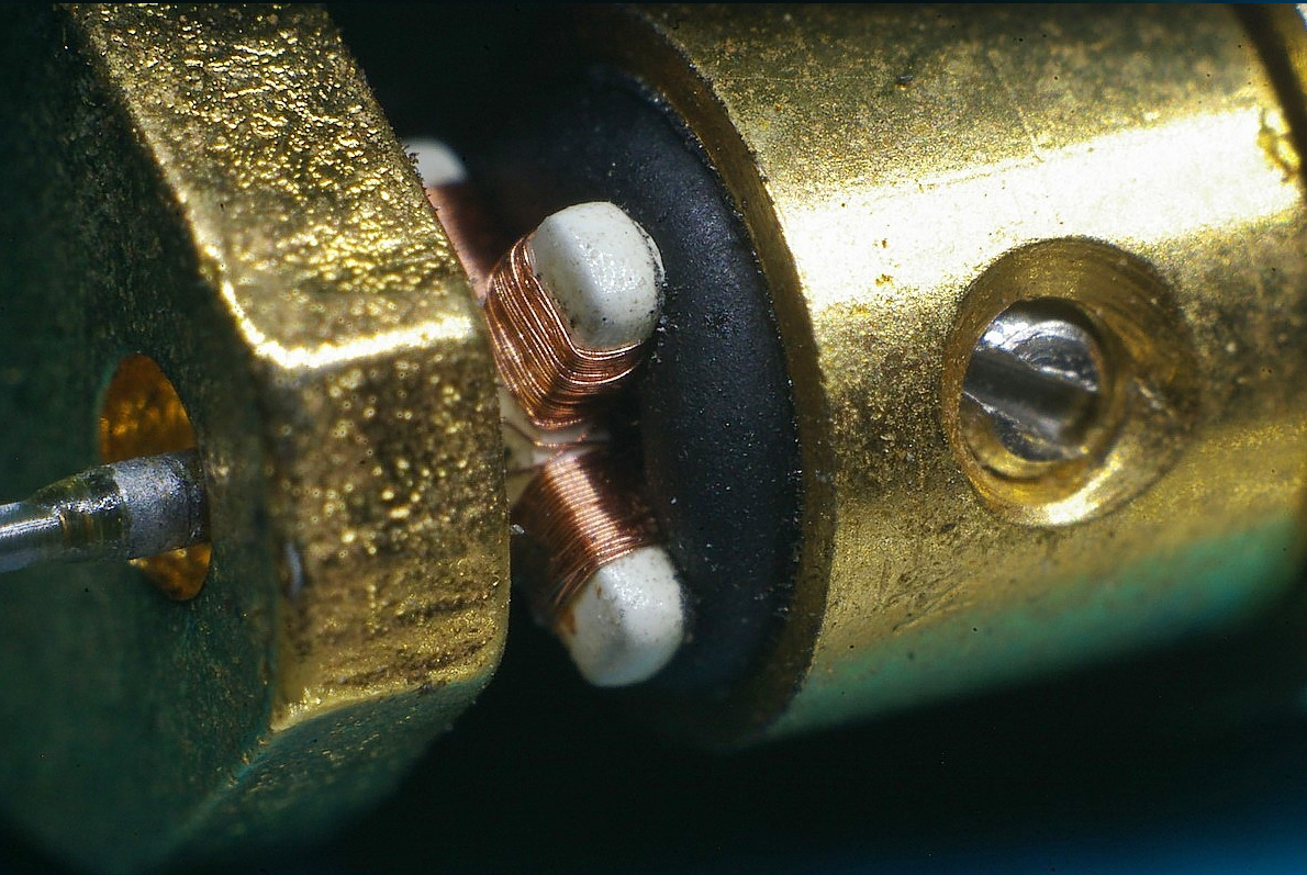

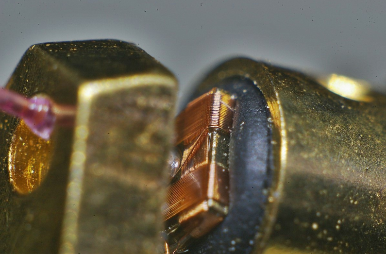

Apologies, Walt - I had forgotten that this site is the forum of “declarative statements” (and no discussion -- much less general) where we need to just sit back and listen. But (for completeness) I think I will finish my thoughts and “rest” -- your personal experiences aside, the number of MC phono cartridges that do not have the “suspension contained in a protected area” is ‘staggering’ -- here are just a few pictures from lencoheaven that show 1.) Black butyl rubber is still a common elastomer 2.) The elastomer/damper is exposed -- if you add Sumiko, Lyra, Benz, and VDH to the numerous Japanese manufactures that make “open” suspensions, it is a pretty healthy number -- if the elastomer is black and slightly porous, it is likely a rubber derivative. Elastomers do age, and (as a result) change the compliance behavior over time (typically not for the better).
File comment: open_style_suspension
File comment: open_style_mc

Yet -- I have never had a cartridge deteriorate like you claim or expect and I ever so often try an old cartridge that was relegated to second string to see how it sounds in the here and now.
One particularly -- the grand father to the Clearaudio design -- a patented Japanese cartridge -- Dianex 1000 (ca. 1978) -- that to this day is still a musical gem. For clarity -- by cartridge "protected area" it is an area that those materials typically used for suspensions are not exposed to an industrial environment where exposure to chemical processing, weather extremes, UV, or other issues that can impact documented expected useful life.
Those days are over for me -- I am forever addicted to DS Audio optical cartridges. Their suspension elastomer is blue in color -- silicon? neoprene? Who knows?
