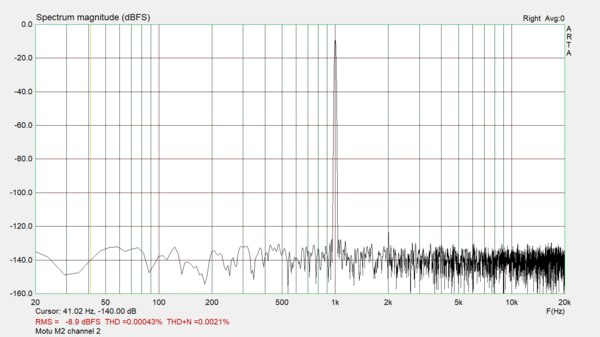

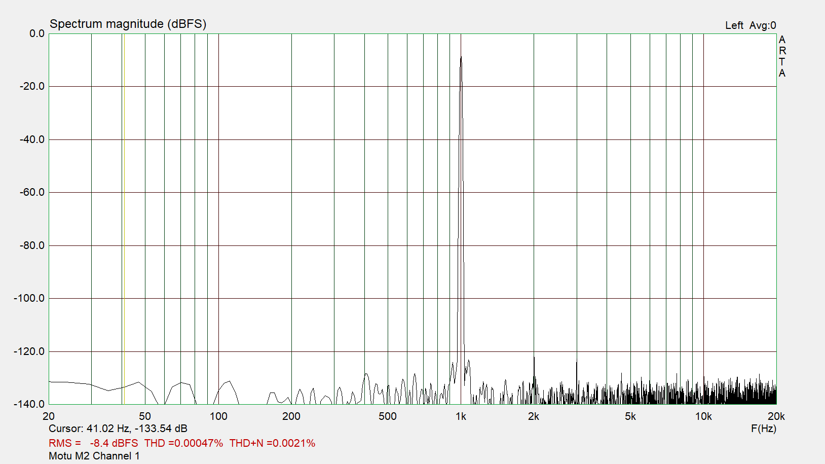

It has updated ESS devices and great specs. I received one today and did a spectral analysis of both channels. The results are included. Vanishing low distortion and noise. It will not be a limit with any measurements you do. I got it on Amazon for $199 and it seems to be a bargain. If you need a USB to audio interface you should look at this one.

I have both units, and the M2 is the one I use for ripping LPs. It's definitely cleaner and clearer than the Scarlett. Thanks for confirming that, I might try it as a distortion analyzer. I use the Scarlett for my narration setup because I actually like the extra warmth. Plus, by the time my clients squash and smash my audio for download, it hardly matters what I use. ;-)

Should work well for your measurements. I don't do music recording but am using both the ARTA suite and Room EQ Wizard for speaker, room, and electronic component measurements. ARTA is going away which is a shame.
