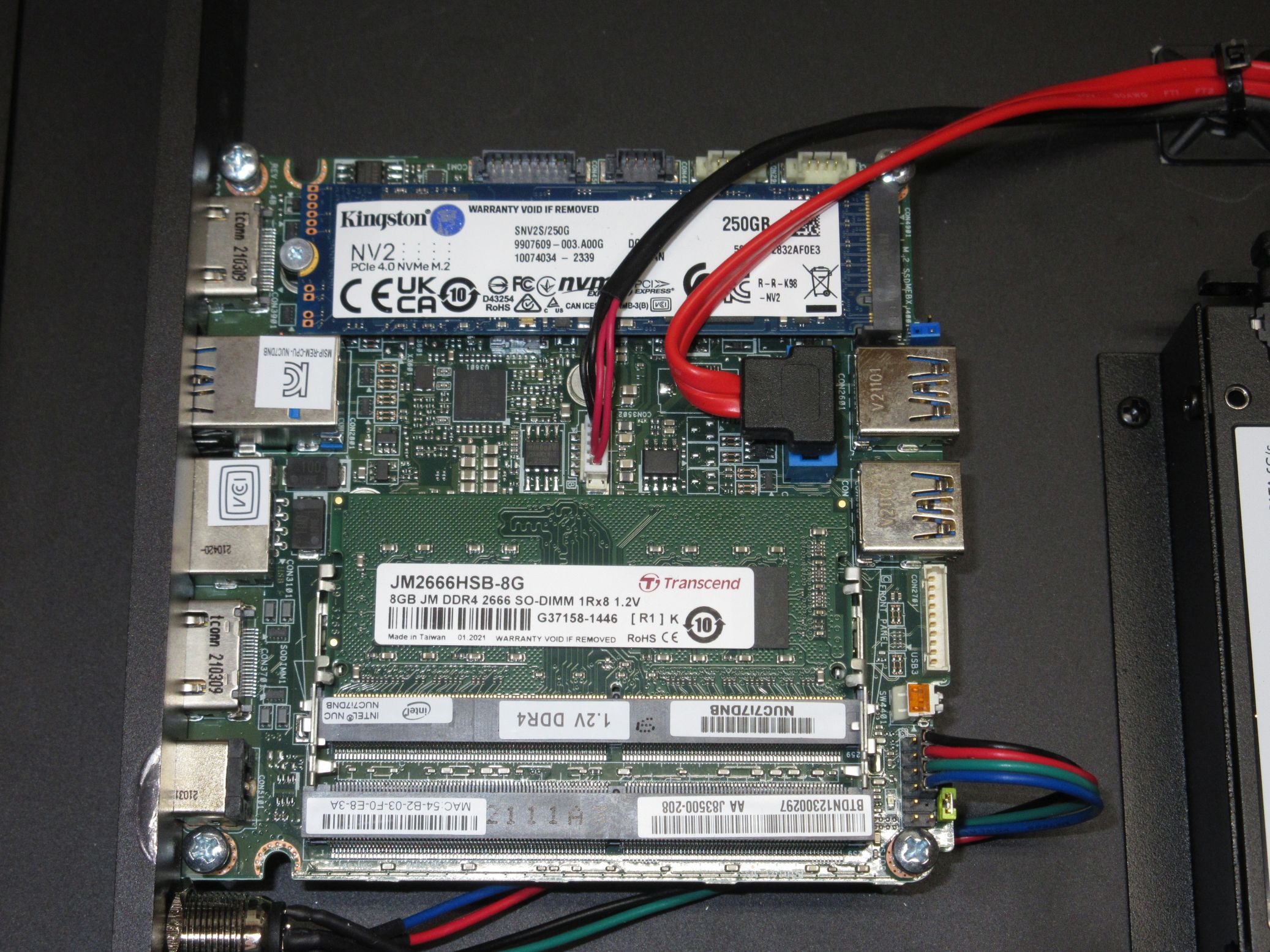

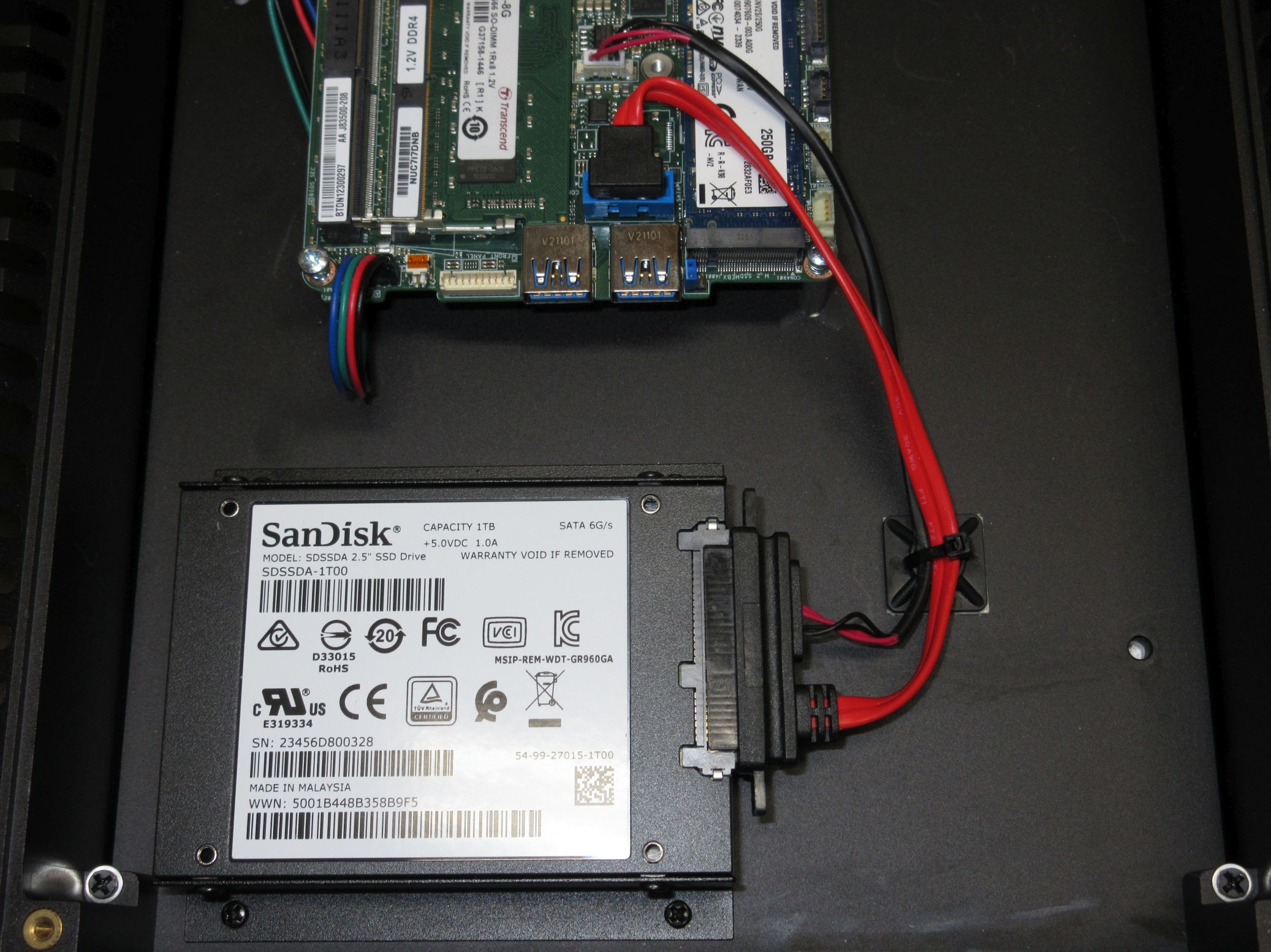

My Roon Nucleus + died suddenly a few weeks ago while it was under the 2 year warranty. They sent me a call tag, repaired it and I got it back within a week including shipping. Great service. All the internal components are on one board inside. When it came back I added an internal SSD for music storage. I'm including photos. Note that the processor board has a 250GB PCie SSD on board to run the processes. The PCie format uses multiple lines for data flow where SATA uses only one which greatly speed up data transfer, in some cases for this PCie 4 as much as 8GB/s.

Thanks for the picture, I never have seen the inside of a Nucleus, but it confirmed my understanding that all it is a repackaging of an Intel 7i7 (7th generation i7) NUC kit in a fanless case of Roon's own design. Note that NUCs are up to 13th generation and continued production has been transferred from Intel to ASUS. I recently built my own updated "Nucleus" with a Gen 13 i5 in an AKASA fanless case, running ROCK (which is the same OS as running on the Nucleus). If you have an out of warranty failure in the future, this can be an option since 7th generation NUC boards are long out of the market. I am sure for now ROON has a stash of them, but that is not forever. Unfortunately, due to differences in heatsinking (both footprint and dissipation), and I/O interfaces between different generations of NUC boards, you may not be able to replace the board with a later generation version. Just something to be aware of in the future. Pete was running into issues with his Nucleus (one in-warranty repair, plus recent issues out of warranty that may or may not have been hardware related), and he was looking into finding a used NUC or NUC kit board of the same generation as backup. That may be a good option for you to pursue, since it is pretty easy to replace NUC boards, having done it a few times.
