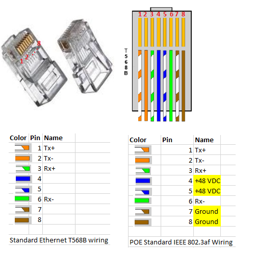

POE goes over pins 4,5,7,8
I do not think the suggested Ethernet surge protectors would have helped Roscoe.
The spike that killed his equipment probably came over the other conductors
