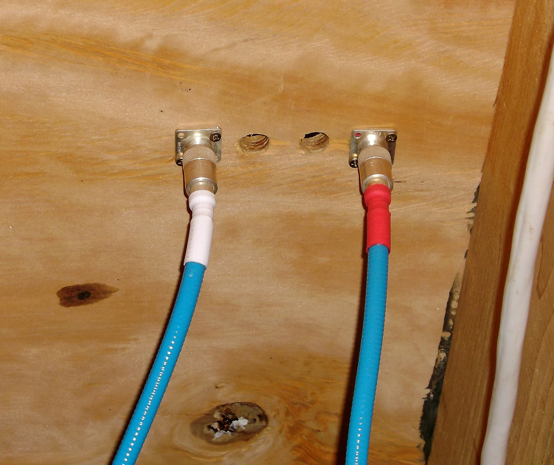

I haven't, but I have had amazing success with Andrew Heliax. The Heliax steps out of the way -- doesn't editorialize -- transparency to the audio signal is an understatement -- and it is very musical.
