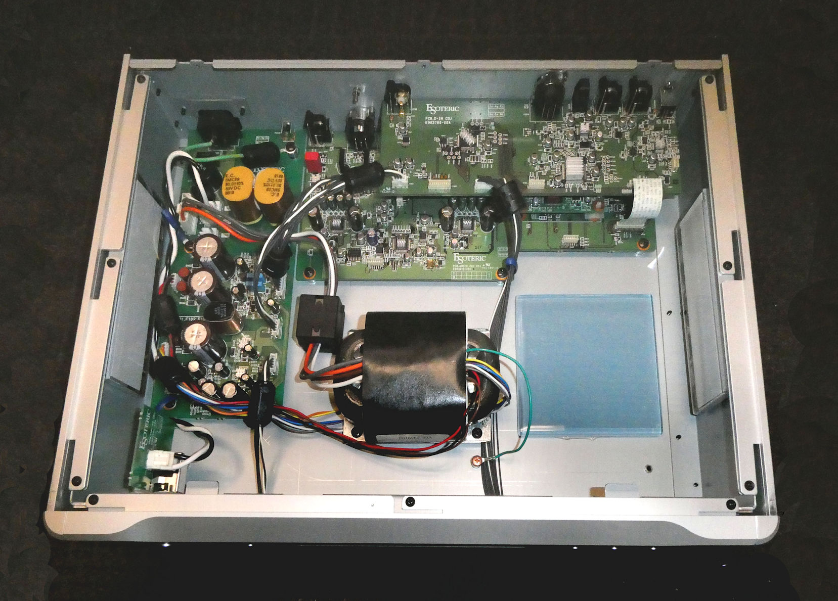

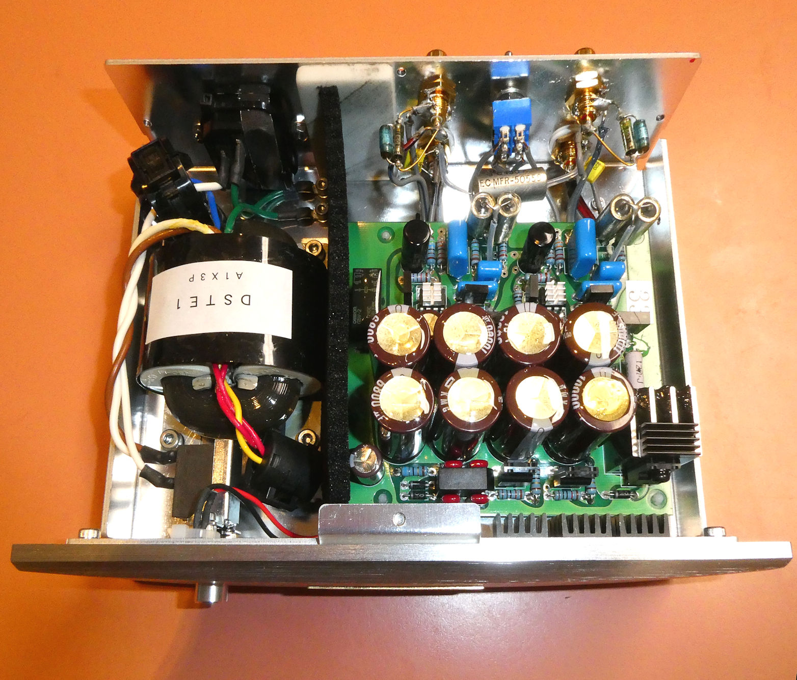

Like the ones in my DS Audio E1 equalizer and Esoteric DAC. Although I guess there are strong arguments for any type transformer whether it be Toroid, R-core, laminated core, isolation laminated core, and whatever.
