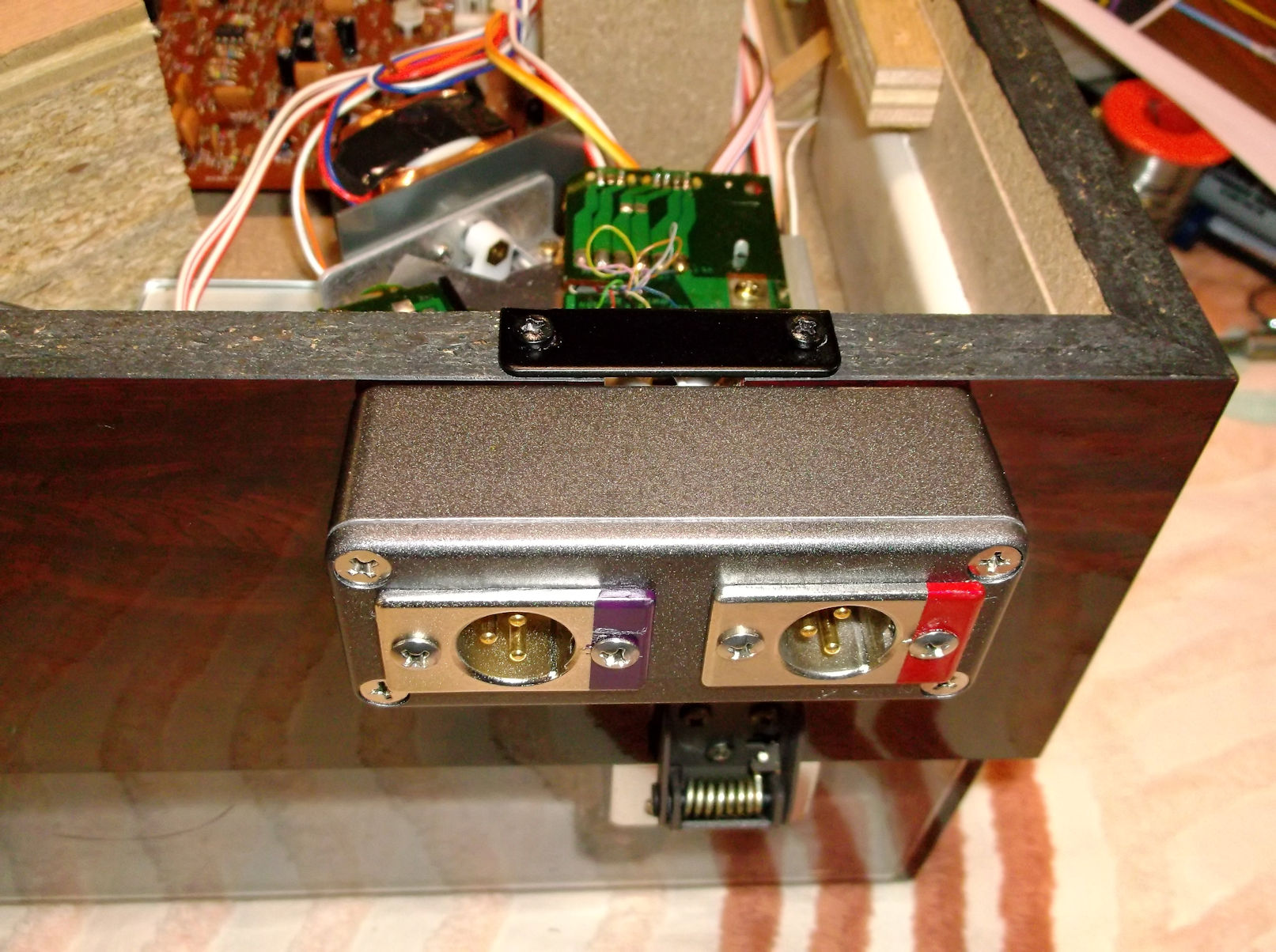

I strongly endorse Rosco's comment. Even with my vinyl playback system that is balanced line (XLR) -- the shorter the better.
