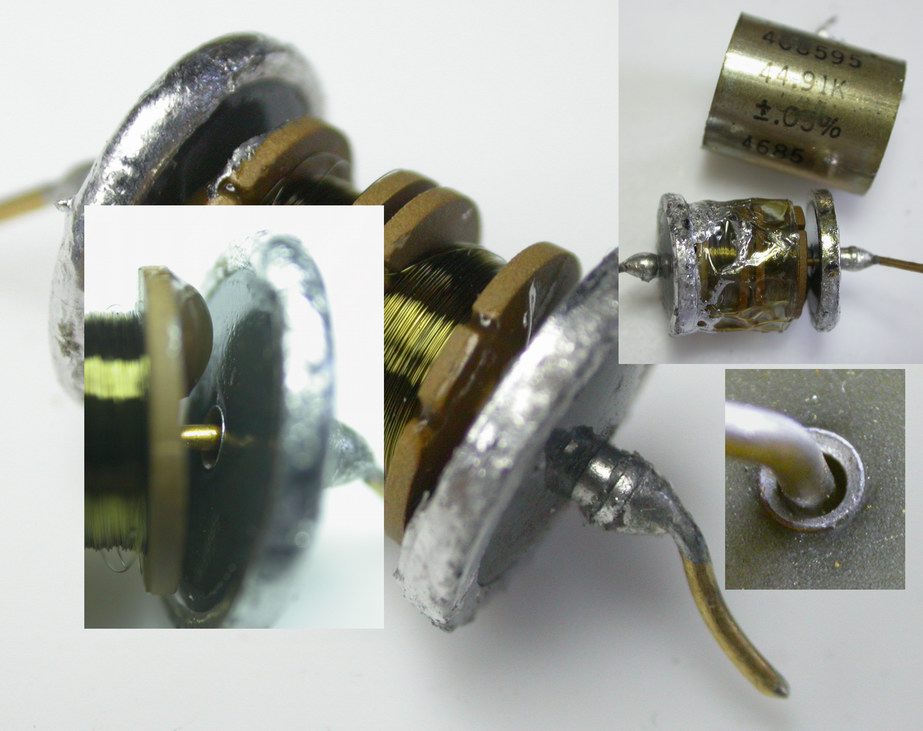

Since you are going line level -- my direct experience with resistors in the signal path that can best serve are in order of importance -- WW Bobbins -- Vishay Bulk Film -- Dale metal film -- Roderstein metal film.
In another thread I talked about a shunt attenuator where there is no pot or stepped attenuator in the signal path -- just a high quality resistor such as that noted above.

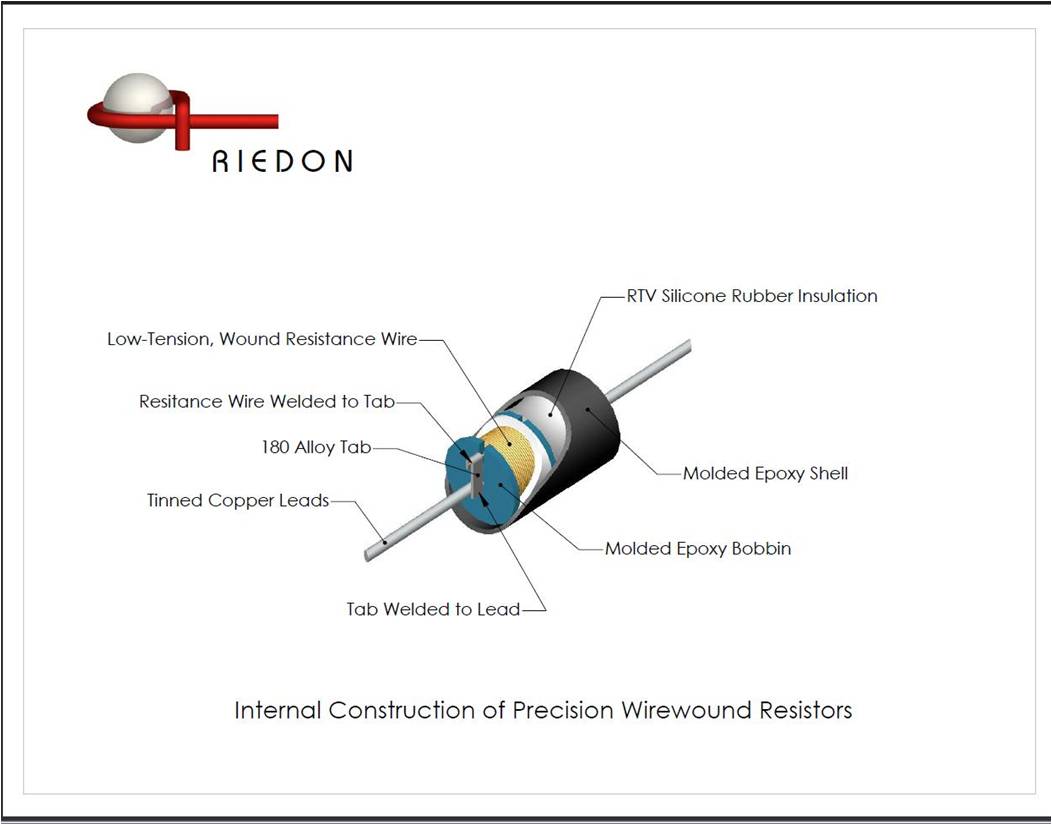

I would not find bobbin type WW resistors. However, I found .3W Riedons on digikey.
