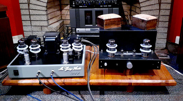

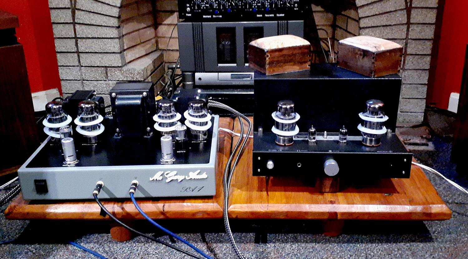

New amp
Modded McGary SA-1 brought to the "E" level.
New caps, better biasing on power tubes, and upgraded power trans

So -- you went Ultralinear in lieu of SET. Does the McGary enable triode operation as well? I ask this because I found that KT-88s (I expect the beefier KT-90 as well) and EL-34s don't seem to do well running Faux triode where the KT-66s seem to prefer that operation.
BTW -- despite what some designers are doing with EL-34s, Mullard originally advised against that operation of EL-34s being that they are pentodes and not beam tetrodes. Their comments included the fact that the suppressor grids would overheat.
And how does the "self-bias" work when they advertise compatibility with a long list of tubes (6L6GC, KT66, KT77, EL34, E34L, 6CA7, 6550, KT88 and KT90)? Is there a means to adjust the bias? Some early designs had adjustable cathode bias. Is that what McGary did?

The SET is still there.
Evaluation of the McGary will take awhile.
Just because I own it doesn’t mean it’s the best.
It sound good, very musical.
It cam with 6550
I will be trying KT66

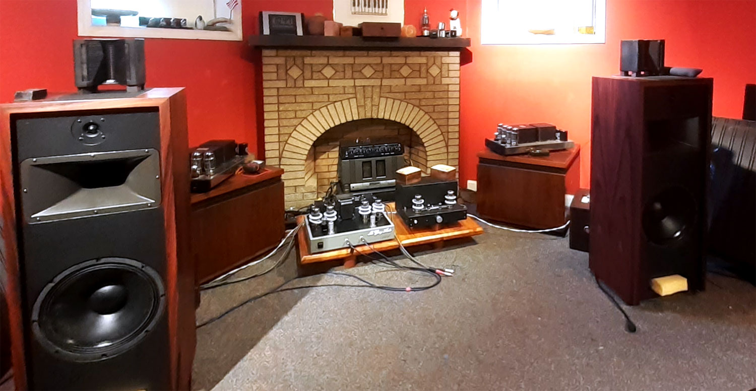

Plenty of power for either the 97db Razz or the 85db Quads.
The biasing in the McGary is cathode bias with a twist that is proprietary and I can’t talk about.
All I can say it’s not microprocessor controlled like PrimaLuna or VAC.
I am almost certain that what they have done with "a twist" is a matter of public record established almost 60 years ago -- so why the mystery?
The versions I have seen include adjustable cathode bias on each tube together with balance between pairs as the most complex -- to just simple tandem-connected cathode pairs with a common bias resistor with bypass.
Then there is the Zener diode "school" that try to regulate cathode bias although that kind of defeats the purpose of cathode bias. Or 3-pin regulators with adjustment -- I've seen that scheme as well. Then there is the ancient G.E. scheme copied by Jadis where you have a certain amount of fixed bias by setting a negative voltage on the control grid as a fixed bias starting point with cathode-bias taking care of "the heavy lifting."
