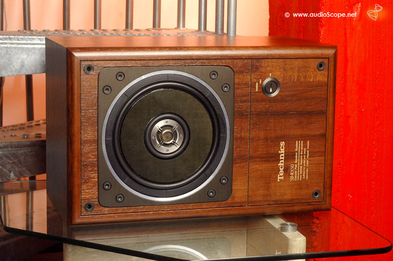

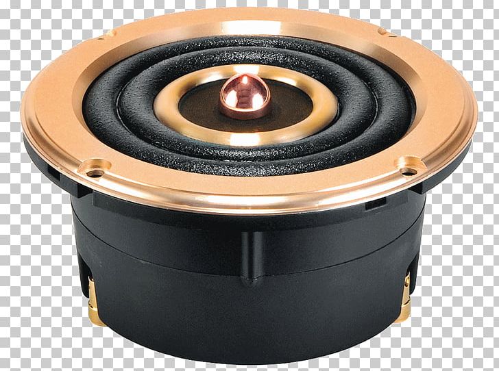

Here are modern versions:
subwoofer-mid-range-speaker-coaxial-tweeter-mid-bass-midrange-speaker.jpg [ 82.51 KiB | Viewed 31739 times ]
