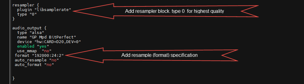

Today, I came across a resampler for mpd called "Secret Rabbit Code"
http://www.mega-nerd.com/SRC/
SRC aka libsamplerate is compiled into mpd. It made a huge difference in my system. The difference is like moving from SS gear to tube gear. The only drawback of libsamplerate is, it is a CPU hog. I set the resample rate to 192kHz/24bit and tried few different types of sources.
With standard 44.1Khz/16bit PCM sources, the music server core was about 24-30% busy. Still, the resampled output was far more pleasing to my ear and there is no skipping.
With 192kHz/24bit PCM sources, music server core was around 27-35% busy and the resampled output was far more pleasing to my ear and there is no skipping. This should work ok for quboz,
With DSD64 sources, music server core was around 40% busy and the resampled output was far more pleasing to my ear and there is no skipping.
However with DSD128 source (Solo by Fiona Joy), the music server core was 94% busy and skipping started and eventually audirvana froze up.
The CPU I am using is only about 2.1Mhz. With this CPU, I cannot play anything over DSD64. Clock speed of the core is the prime important factor for quality music server implementation, which means we have to venture into HT/Gaming PC area. We dont need more than 4 cores. AMD Ryzen CPUs can be overclocked to 4.7MHz. Check out the hardware at Microcenter. Quality PSUs produce a max of 18dB and liquid cooling system with fans about 24dB. It will be a mid-tower which I would tuck it behind the speaker. My DAC can play 786kHz/32bit sources, which has to wait until I upgrade the server.
For anyone who wants to try out the libsamplerate resampler, make the following changes in /etc/mpd.conf and bounce it. I doubt it will work with low-end CPUs like atoms and celerons.
DaveR, I read on that libsamplerate plugin is available for foobar200, if you wanted to try.

Thank you, Shahsi! Not sure I can implement this but it's very interesting.
