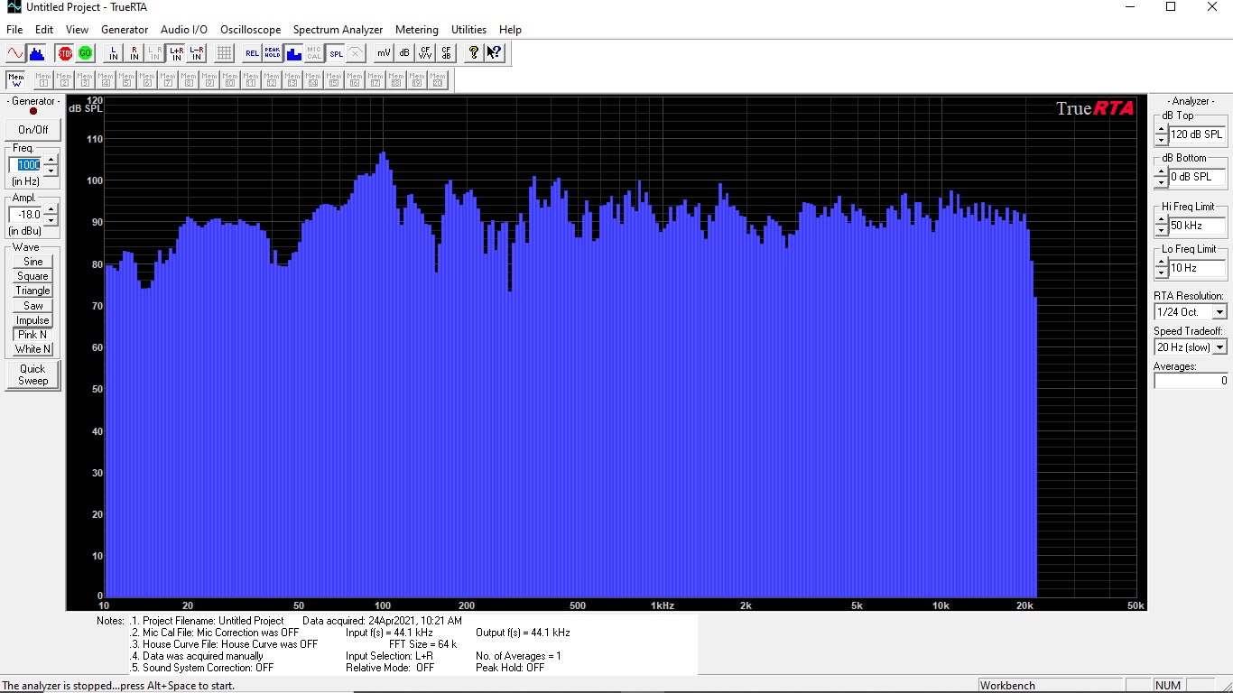

I have been trying to get rid of a 100hz bump in the Razz speakers. The designer likes this bump. He calls it the "Fun" part.
it was only a few db's and by moving the speakers around I have reduced it by half. The fun part for me is to watch this on the
real-time analyzer. It took just moving the speakers out into the room about 6 inches.
My first try was to partially block the port with open cell foam. That helped but now with the change in position it now sounds better without the block.
PostPosted: April 29th, 2021, 4:26 pm
this is before I moved the speakers
I didn't keep the graph of after the move.
but you can see there is too much lo bass and its a bit boomy
PostPosted: April 29th, 2021, 4:35 pm
Paul,
100Hz has a wavelength of 11 feet, so if you are 2.75 ft (1/4 wavelength) from a boundary (like the back wall), that should cancel out at the speaker. Of course considering all the room reflection modes and standing wave resonances, it is much more complex that this. So positioning can have a pretty big impact on low frequencies.
