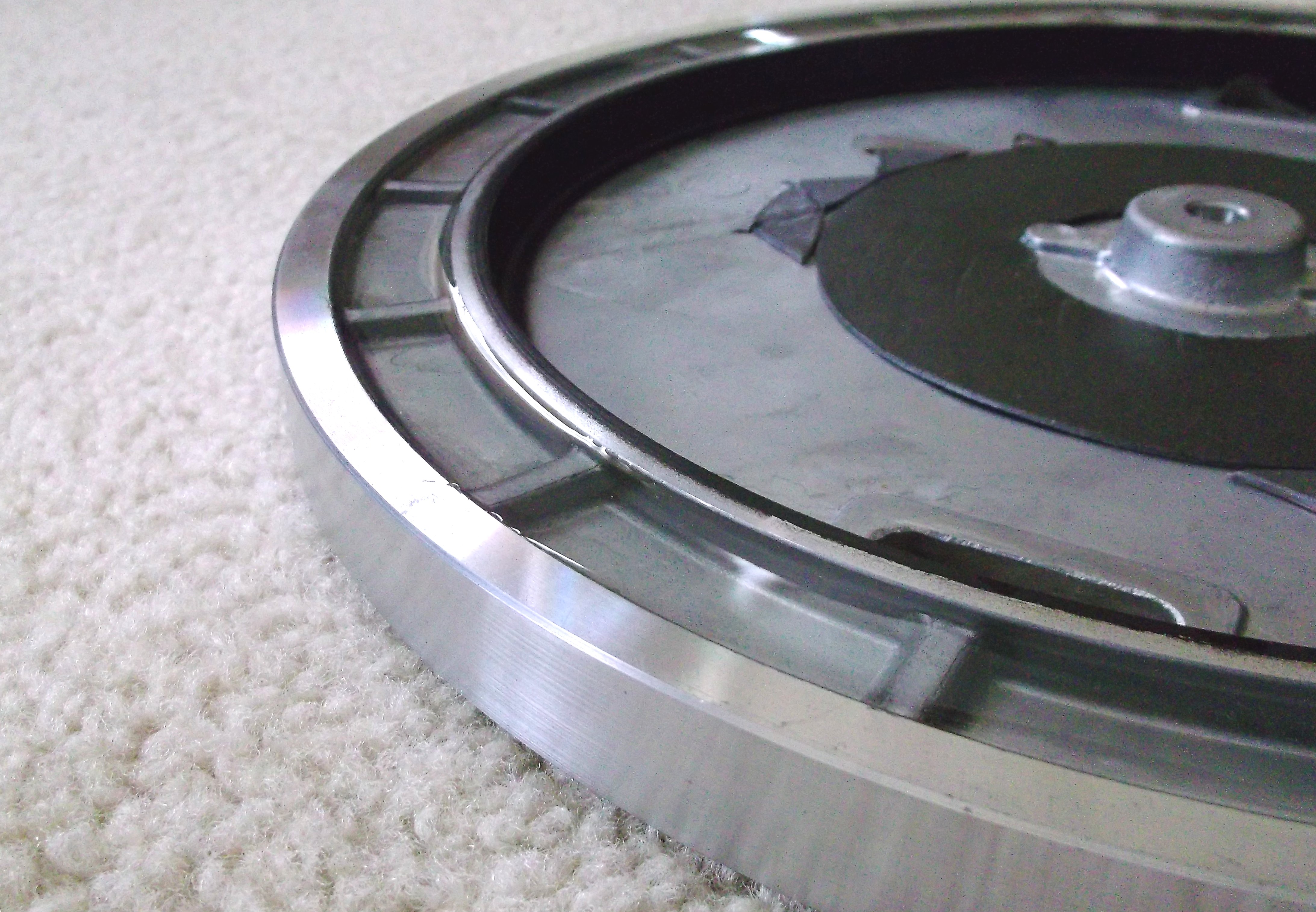

I use a Denon DP-59L DD TT and it runs beautifully -- especially the servo-controlled anti-skate and arm damping. If anyone out there has a complaint about the Denon DL-103 bass quality it can be much improved with arm damping.
Just like Roscoe pointed out -- the inside of the platter has the magnetic strip. What's different with the Denon is that it uses an AC motor and VFD control instead of a DC motor that is discredited because of cogging. I think some out there made a mountain out of a mole hill. Sure a DC motor cogs but the inertia of the heavy platter (fly wheel) eliminates that issue as evidenced by my experience with my Yamaha YP-D8 DD TT.
