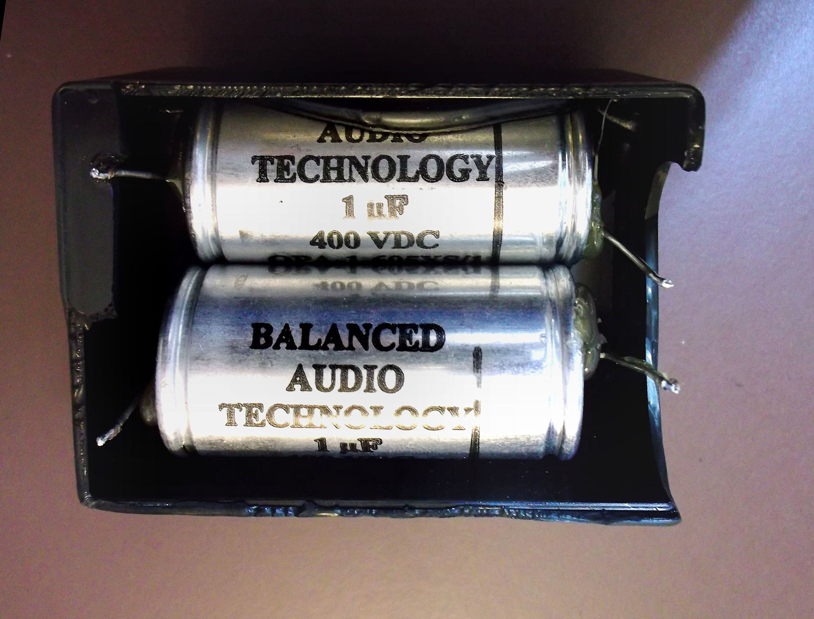

That said – it was time to re-cap (all power supply electrolytics) my pre-amplifier (a Balanced Audio Technology VK-3i – 6DJ8s or 6922s or 7308s with 6V6 current sources). Since time has passed, the BAT pre-amp was already 23-years-old and yet I had no desire to replace it. Since the work involved full disassembly I also took a hard look at the output coupling caps for upgrade plus some resistor upgrades. Since it is a balanced design we’re talking about four matched output caps. The stock offering was Jensen aluminum paper-in-oil caps that I bypassed years ago with Teflon caps. Those of you that have heard my system recognized that the pre-amp acquitted itself very well.
Before committing to a change -- I performed trials using a DC-coupled pre-amp (Spectral DMC-10) and an adapter that I made to evaluate coupling caps and resistors in the signal path against a straight wire. I was leaning toward my preference until I discovered some Russian caps in my inventory that I long since forgot about. To make a long-story-short these caps were represented by the seller as polycarbonates and they were set aside since they did not perform well in trials for my speaker’s crossover.
As it turns out they were NOT polycarbonates but hybrid capacitors. HUH? They were confirmed by the product number K75-24 and as it turns out have a “cult” following with one manufacturer using them in their hi-end phono pre-amps. (the $12,000 Brinkmann Phono stage “Edison").
These caps are a metalized-paper-in-oil together with a mylar (polyester) dielectric. Products of the Cold War that defy reason or experience when it comes to all things audio. Bypassed with Teflon caps the combination provides an open, grain-less, flesh-on-the bone level of reproduction that far exceeded any expectations I had. WOW!! “See-through transparency" – amazing 3D mid-range performance – together with a smooth-musical character that does not smother. Vocals especially are a treat. Strings do not sound like screaming cats. Keeping in mind that the Jensens were the product to beat. Hell -- my polycarbonate favorites didn’t even make it a contest. :thumbup: :violin:

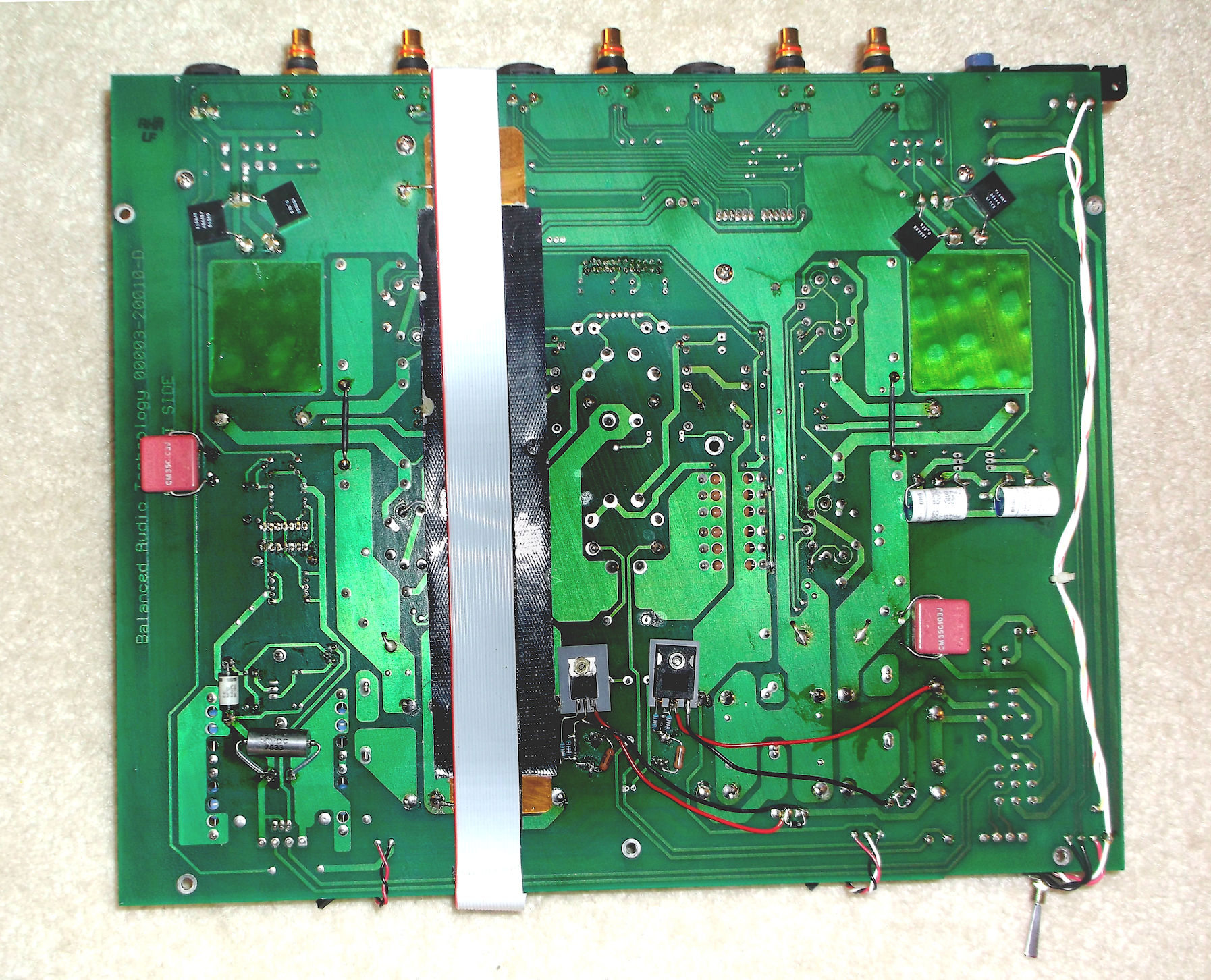

I discussed the end result when I announced the discovery of the Russian Hybrid caps. As far as global upgrades are concerned -- the question is -- what didn't I do?
All of the power supply caps were replaced with industrial-grade products having a 105-degree C or better rating and designed for long life and low ESR.
The 1-ufd power-supply bypass caps were replaced with 20-ufd polycarbonate caps bypassed with .27-ufd CRC hermetic Teflon caps
The 1-Kohm grid-stop resistors were replaced with RN-65 Vishay bulk-film resistors. The input resistors were candidates but "buried" under the four volume control boards (disassembly is not recommended).
The Jensen output couplers were replaced with hermetic 2.2-ufd K75-24 Russian hybrid capacitors bypassed with .25-ufd Tex-Cap hermetic Teflon caps.
Output buffer resistors were added as the pre-amp was designed without any. ??? I installed Vishay RN-90 bulk-film resistors.
Past mods included shielding to limit RF contamination from the digital volume level controller. I also added 2-ufd capacitors across the filament supply to the 6V6 current sources
Tube complement is Eastern Block Amperex ECC88s and mil-spec RCA metal jacket 6V6s. Teflon damping rings were installed on the ECC88s and Pearl Coolers on the 6V6s.
Case work included extensive constrained layer damping where-ever possible using ceramic tiles and RTV silicone.
Since I am obsessive (no surprise there) I blinged-up the cosmetics.
Was all that WORK justified and worth it? DAMN RIGHT!!! I had no interest in any other pre-amps either new or used. For me -- this baby is a keeper!
