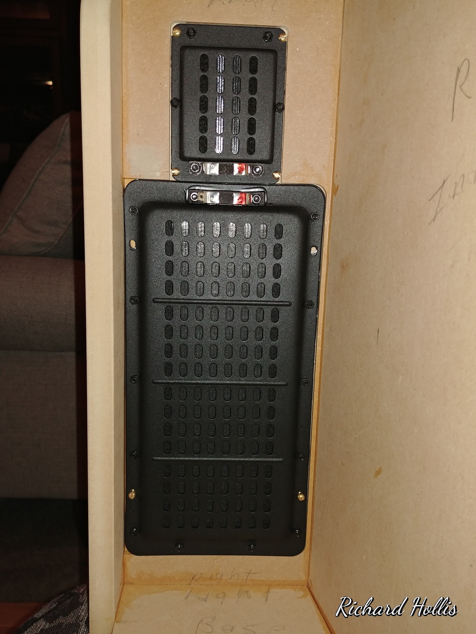

I have tested both the GRS 3" and 10" planars in The Monoliths open baffles and they are not clones of the BG's, so both crossover and baffle mods would be needed for an existing design to use them.
They are also a bit different in size, so that makes mounting them for a comparison to listen an issue.
Be careful with measurements on them. Another person that did measurements melted his 3" planar diaphragm and not at high SPL levels. It can happen to the BG's as well.
All that said, still going to see what happens with some crossover mods. It is not going to be fast as I am still getting the basement back together after water damage repairs.

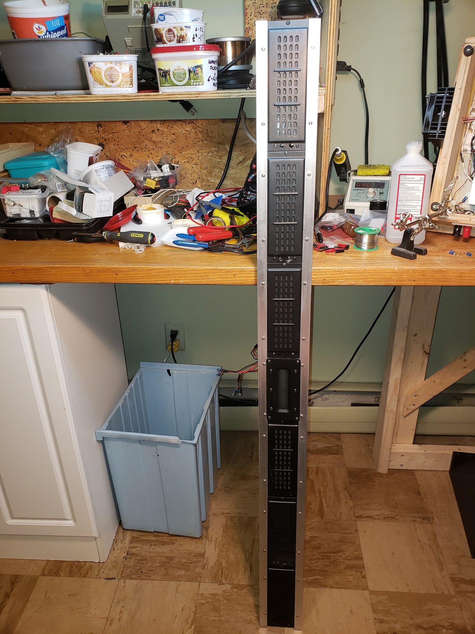

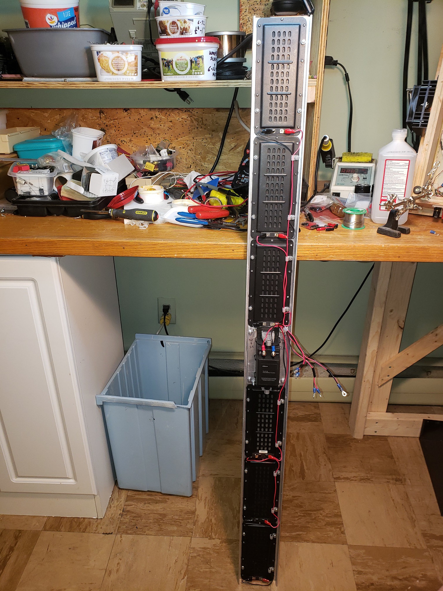

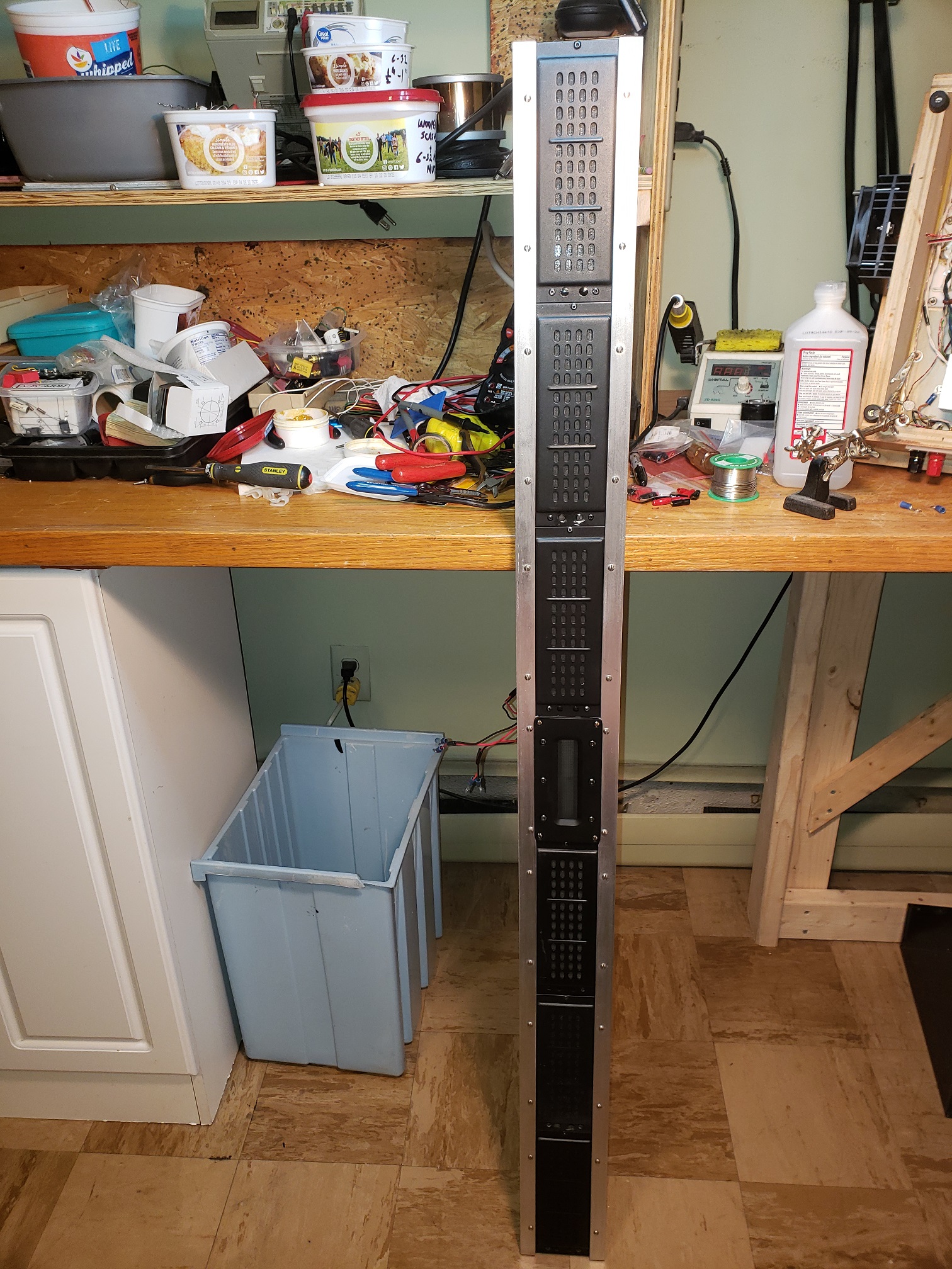

I'm working on it! 6 x BG8 with Fountek NeoX 3.0 in center of line.

You may want to look at the theory here for line arrays -

An asymmetrical wing works well with the BG drivers to keep the LF response and give really nice imaging with the small frontal area.
Here was my test fit of the GRS 3" and 10" planars in my existing open baffles for measurements.
