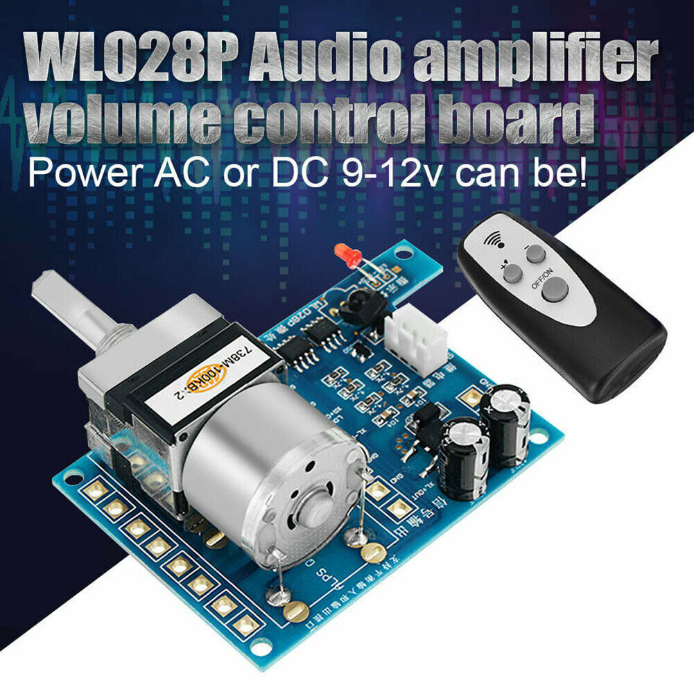

I know that many DIY'ers have built their own pre-amps that do not have remote control capability like the many commercial products out there on the market.
I stumbled on an eBay offering who's time has come -- check it out:
https://www.ebay.com/itm/US-Remote-Cont ... %7Ciid%3A1

Interesting that you can use 4 pots for balanced inputs. There are some other solutions out there that also allow remote switching of the inputs.

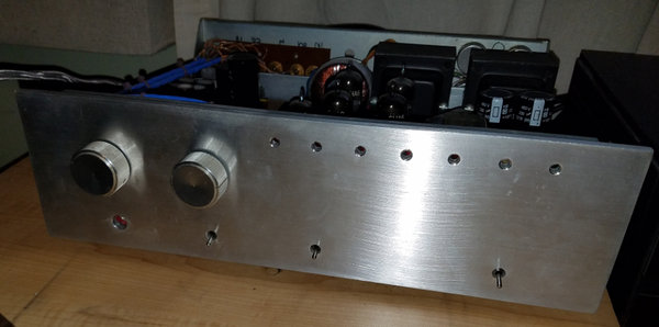

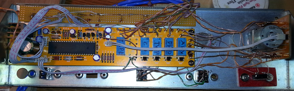

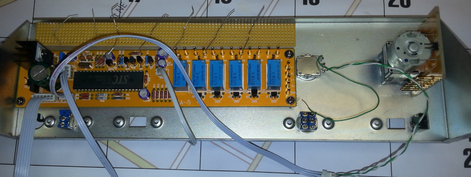

I used a similar product a few years back. Works well. Used a 4-gang Alps motorized pot. Paralleled sections to net a 25k pot, but with two wipers per channel.
The one posted should be excellent for a simpler build.

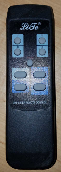

The remote
