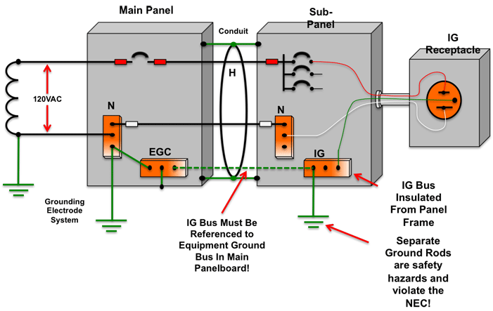

Computer facilities and hospitals have what is know as an isolated ground system. The specialized receptacles (orange color) have your typical hot and neutral feeds, but the ground bond goes straight back to the service entrance.
Pictures speak louder than words -- attached is an illustration. And -- to ad insult to injury -- you can created a ground loop causing your audio system to "hum" the words.

Walt is absolutely correct about running alternate grounds from a sub panel. That will cause the code people to have a fit. However, there is nothing to say that you can't run a separate ground from, for example, the ground on a turntable arm. As Walt says, you may cause more problems with ground loops depending on where the alternate grounds are in relation to the main service feed ground. Other than violating codes, there is no one solution for lowest noise. As I found when running a USB DAC off my laptop, the internal laptop noise filter shunted noise from the inside of the laptop to the power supply ground which then traveled down the house ground wires to the amplifier causing noise. There was enough impedance in the house ground wires to cause the grounded body of the input jacks on the amp to pick up the noise. Having a super ground somewhere near the service panel would have done no good because the noise occurred on the ground wiring itself in the house walls before it got to the ground point. Finding noise sources and correcting the problems is one of the most difficult things.

8 foot ground rods should be considered supplemental only. Their impedance is ridiculously high; no matter how large the service (even 4000 amperes) the grounding electrode conductor to a driven rod never needs to exceed #6 AWG copper!!!!! The rod simply cannot conduct any more current.
Want a good ground besides the superb cold water ground? Use a Ufer ground. That is a foundation ground. If there isn't one in your house, the procedure is to dig a 20 foot long, two foot wide by two foot deep hole, install rebar, Cad weld the GEC to the rebar, and encase the assembly in concrete. That is a low impedance ground.
If you are going to drive a shitty ground rod and connect it to your stereo, consider this . Unless, you have a separately derived system (transformer coupled, galvanic isolation, no current path between primary and secondary windings) the ground you add is in parallel with the household grounding electrode system as well as the utility center tap of the transformer feeding the service.
So, if a ground fault occurs anywhere between the transformer and any branch circuit in the house, a portion of the fault current WILL flow through your stereo ground, perhaps right through your tonearm!
There are good reasons for the Code rules. Flout them at your own risk.
ALL GROUNDS IN A STRUCTURE NEED TO CONNECT TO THE GROUNDED CONDUCTOR (NEUTRAL) AT A SINGLE POINT UNLESS WORKING WITH A SEPARATELY DERIVED SYSTEM!
