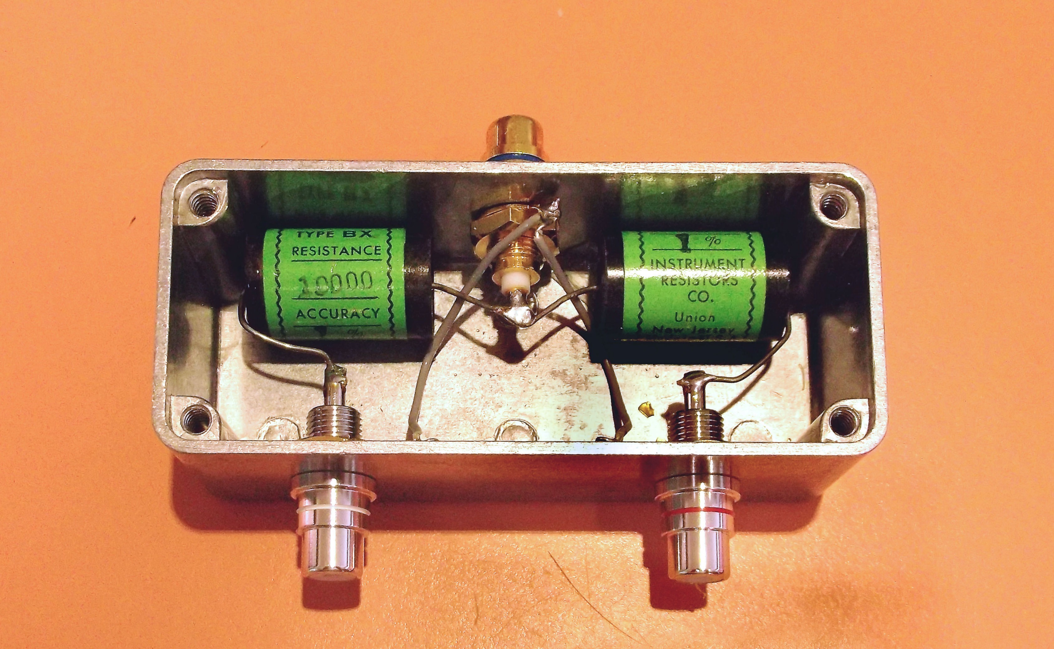

Author:  SoundMods [ April 14th, 2020, 11:39 am ]
Post subject:  Re: Audio summing circuit
I have a question for the experts: besides the resistors, is there any other component or design recommended that would make it a better circuit?[/quote]
Roscoe passed on the information you need. There are many ways to integrate sub-woofers. Attached are photos of my "He-Man" passive sub-woofer summing network.
The interconnect run is 8-meters to the corner loaded sub-woofer's integral amplifier. Cross-over is about 40-Hz.
The sub-woofer is capable of getting down to 18-Hz. with room shaking power.

Author:  SoundMods [ April 14th, 2020, 2:56 pm ]
mix4fix wrote:
Every once in a while, I see someone trying to use a Y-cable to go from two-to-one with no summing of any kind. I have always used that link to educate someone. Plus, back then, I don't believe their was too many pre-built summing circuits. I have always trusted the 1K ohm, 1/4 watt resistance recommendations for years.
I am talking about design. I see 20K ohm resisters. Is that overall better, of just for your equipment?
The benchmark is 10,000 ohms or larger for a summing network at line level (pre-amp). Using 1,000-ohm resistors allows a certain amount of Left/Right blending in your main stereo amplifier that you don't want.
Of course if you need isolation rather than what a passive network provides then using an op-amp is preferred and that methodology is contained in Roscoe's link.
Just about any transistor pre-amp will have +/- DC supply voltage that you can "piggy-back" on. Tube amps forces one to build a power supply for the summing amplifier if a passive network is not your "cup-of-tea."
My summing network got the job done with minimal effort using precision bobbins. I did it first with Dale RN-65 metal-film resistors and they somehow caused a pre-amp sound-quality problem. OK. So I pick nits.
If you are summing off of the low-impedance speaker outputs (4-16 ohms) then 1,000 ohms should be fine.
