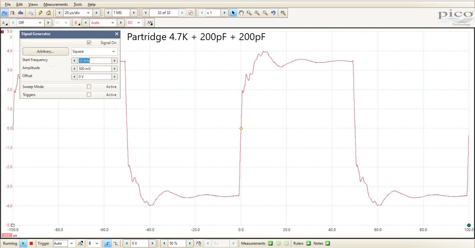

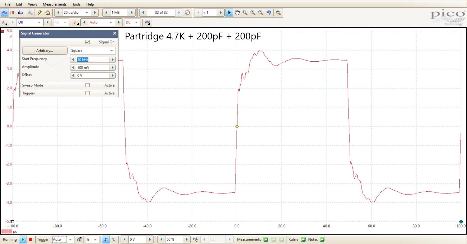

I'm restoring/updating a pair of Heathkit W4's I bought a while back and replacing the original Chicago OPTs with a pair of Acro TO-300's, a far nicer OPT. So now they'll be sort of hybrid W4/W3A-M's. Then I want to get my "Musician's Amplifiers" off the breadboard and into a final build with the Peerless S-265-Q's.

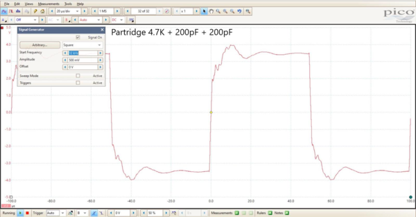

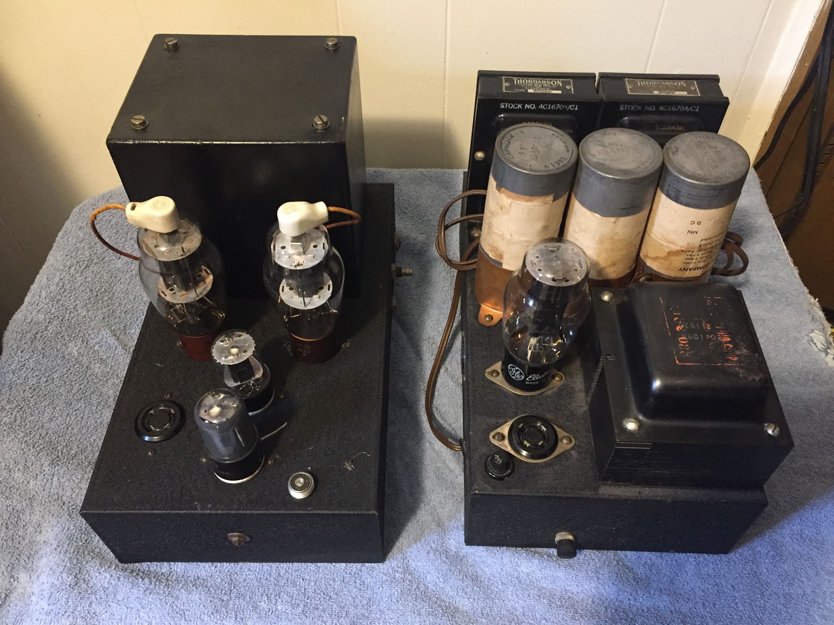

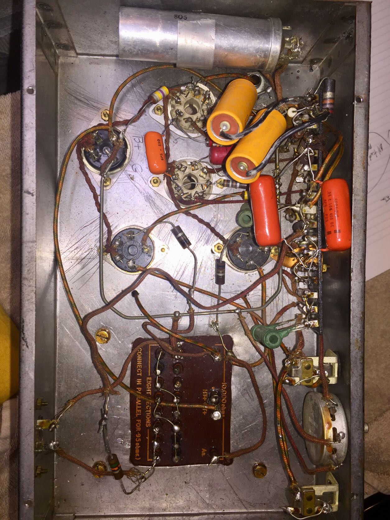

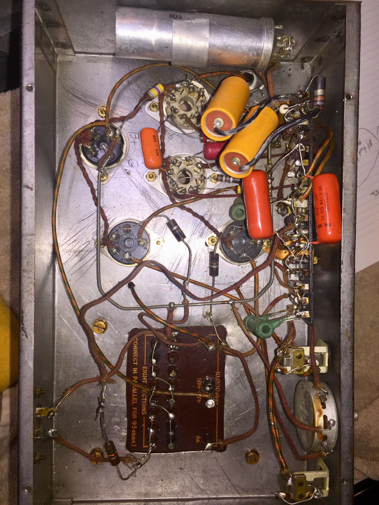

I also restored/updated an old homebrew 807 Williamson a guy on Audiokarma found. Man, it was a mess, A monumentally amateurish build (yes, those are bare twisted plate leads running right under the ground buss) and would hardly have been worth the effort except that it had a Partridge WWVB output transformer that was worth salvaging. We tried to figure it out long-distance but the guy was understandably a bit daunted and finally just sent me the signal chassis. Pics below. I was also interested to measure the WWVB and see what it looked like on a scope. What a disappointment. Couldn't get a decent 10K square wave out of it. I did my best but getting it stabilized was a bit beyond my skills. I tacked in a Peerless to make sure it wasn't the build, but the Peerless looked perfect. But it's up and running and sounds nice enough.

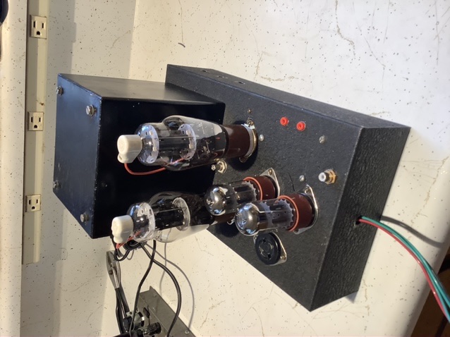

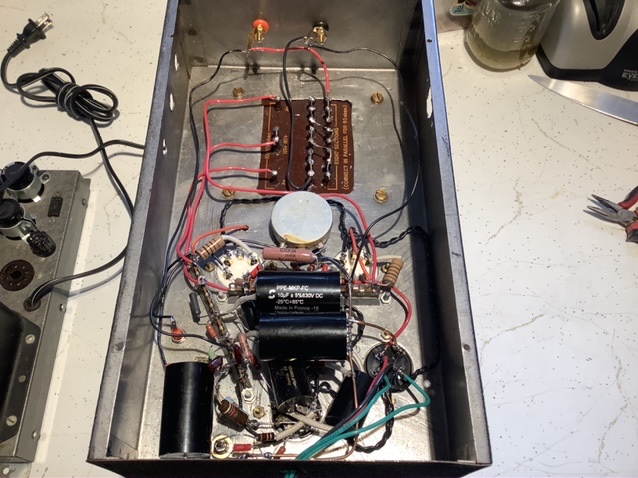

Here are the after pics. That's a temporary umbilical for the Heathkit W2 power supply I used to work on it.
