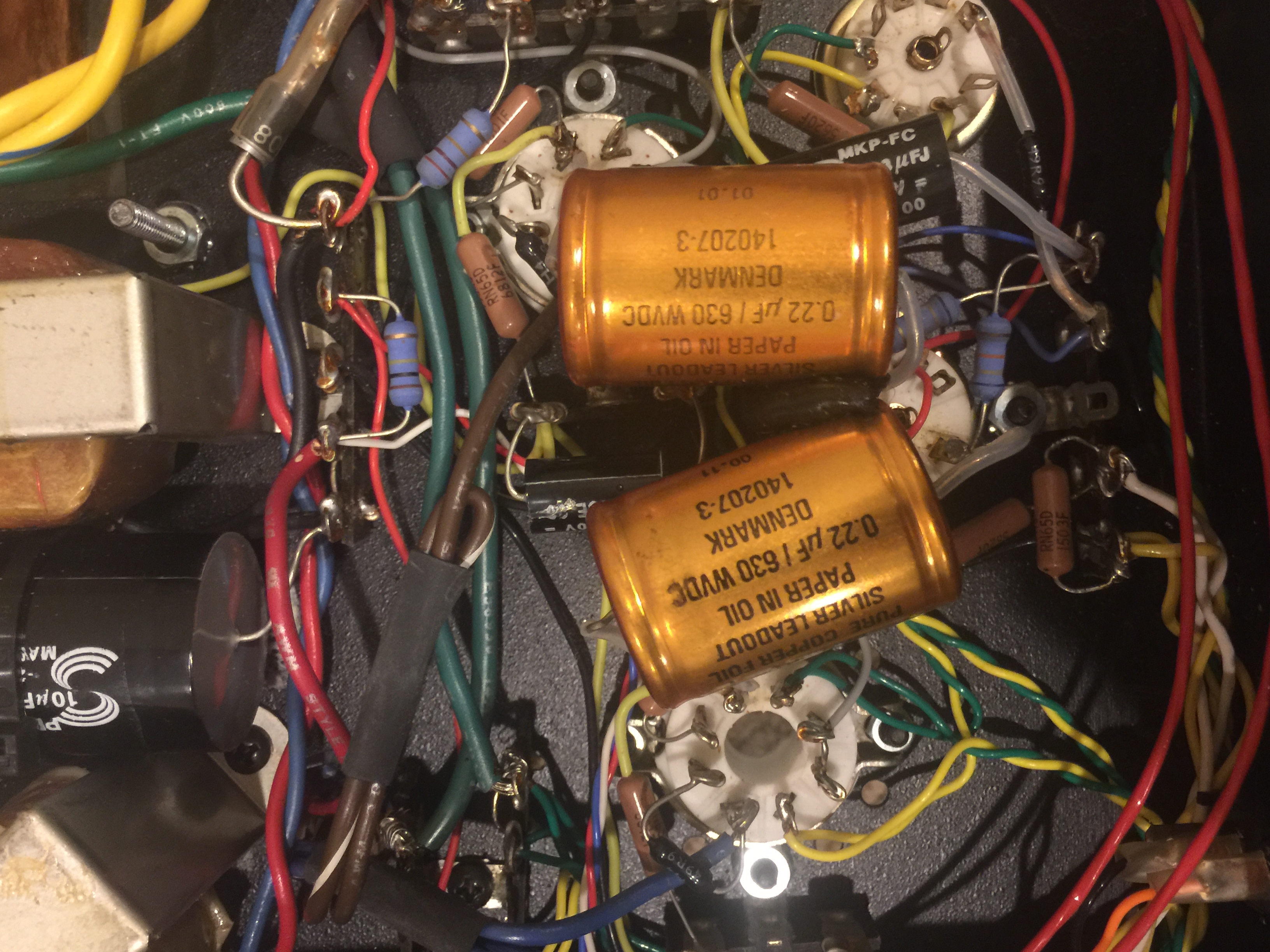

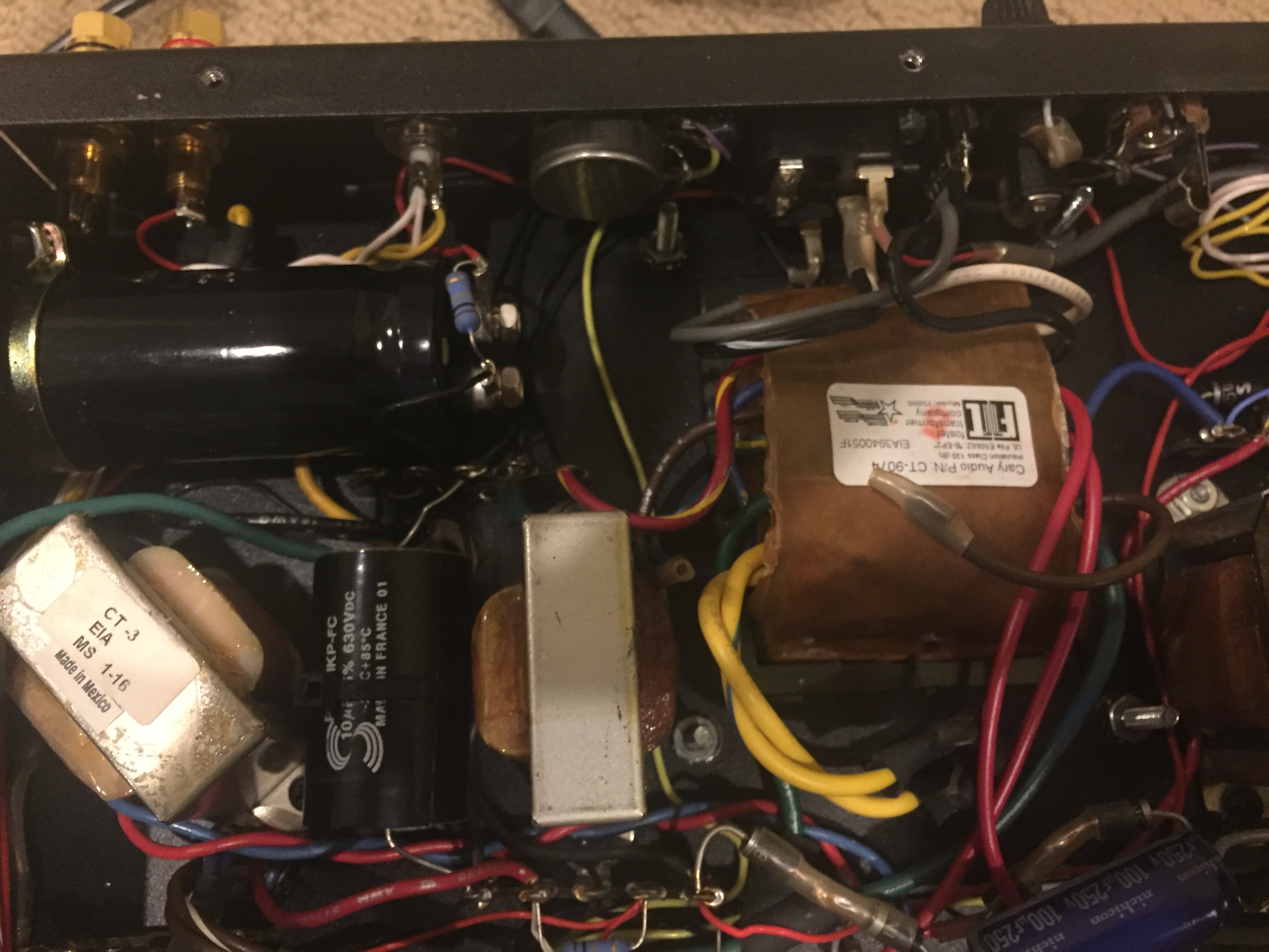

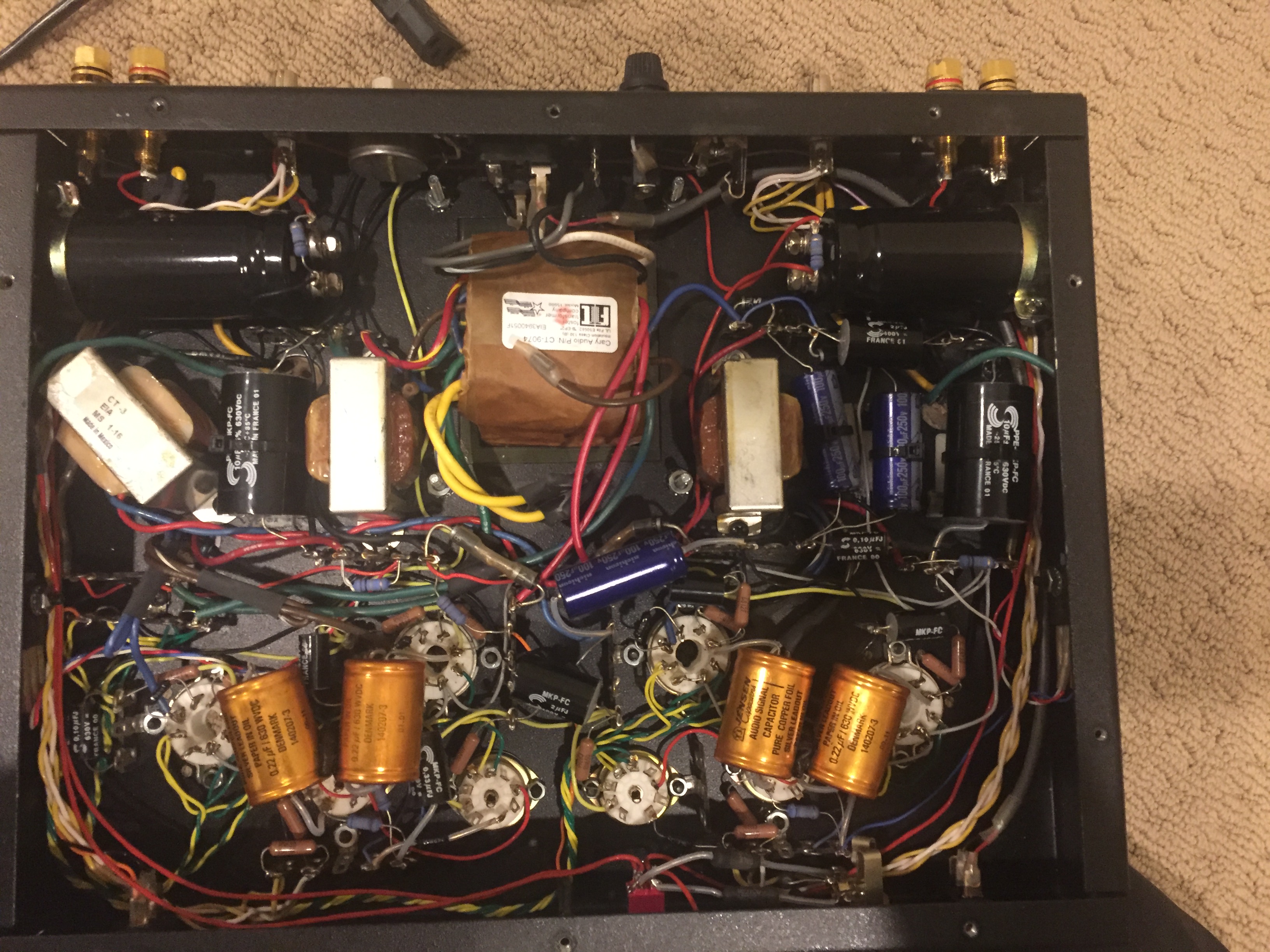

You could also post some pictures. Many eyes might see something.
Ray

I would add one more task to the excellent advice already rendered -- open it up and carefully inspect the amp. for any parts that appear stressed. Either it will be the stressed part a good place to start with repair or you can drop it from your check list if everything looks good.

I powered it on without the tubes and the fuse blew in about 10 seconds. Assuming the problem could in PS section? All the solders and the caps look okay. Attaching a few pics. Any suggestions?
