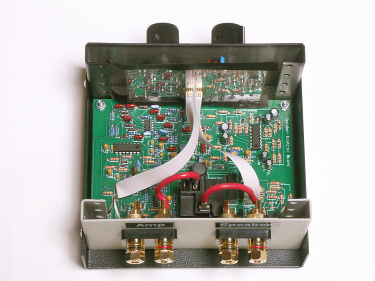

Just for grins, here is a photo of the completed board I showed above in the enclosure. You can get an idea of the quality of the finished board.
